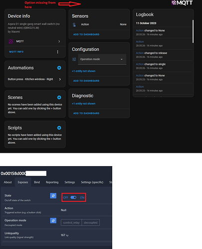

Before id fixed the issue and was still panicing, i got this message on several of my light switches: “This entity is no longer being provided by the MQTT integration. If the entity is no longer in use, delete it in settings.”. I wasnt really thinking straight at the time and clicked to delete it.
What it looks like ive done, is removed the “control” card from the lovelace device.
However I can still operate it from the “state” toggle on the device in the MTTQ device settings, but i cant work out how to get the “controls” card back into the lovelace device
Ive removed the device in lovelace, removed it from /config/zigbee2mqtt/database.db, removed it the ziggby device, restarted HA and then re-paired the switch, none of which makes a blind bit of difference.
Anyone know what im missing? Essentially my current HA config means ive got a dumb switch.
