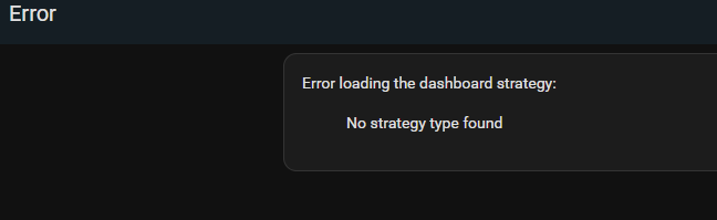

Somehow, I managed to “destroy” my overview dashboard.
So I completely emptied it in raw mode and saved it.
But now I get the message: “Error loading the dashboard strategy: No strategy type found.”
In raw mode, I get “Cannot: read properties of undefined (reading ‘startsWith’).”
How do I get the overview dashboard back?

Thanks for the code, but the result is the same:
Dashboard shows:

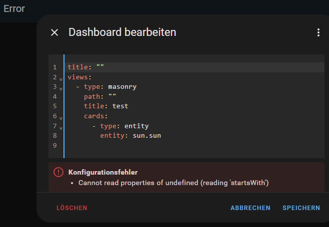

In raw yaml there is below the editor:
  • Cannot read properties of undefined (reading ‘startsWith’)
Try adding this code then
title: ''
views:
  - type: masonry
    path: ''
    title: test
    cards:
      - type: entity
        entity: sun.sun
This should give you a dashboard with the sun entity
Nope, same as before
