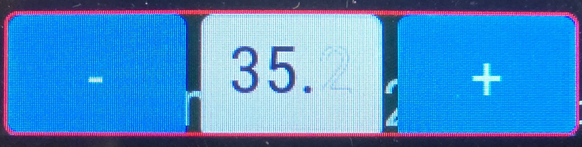

Not Getting Something quite right with this.
When I try & remove the cursor I get this.
The Outline of the Font, but no fill.
              - spinbox:
                  align: CENTER
#                  text_align: CENTER
                  flex_grow: 1
#                  width: 70
                  height: 70
                  range_from: 30
                  range_to: 40
                  selected_digit: 0
                  rollover: false
                  digits: 3
                  decimal_places: 1
                  cursor:
                    bg_opa: transp
#                  on_value:
#                    then:
#                      - homeassistant.action:
Anyone tell me what’s wrong.
Thanks.
