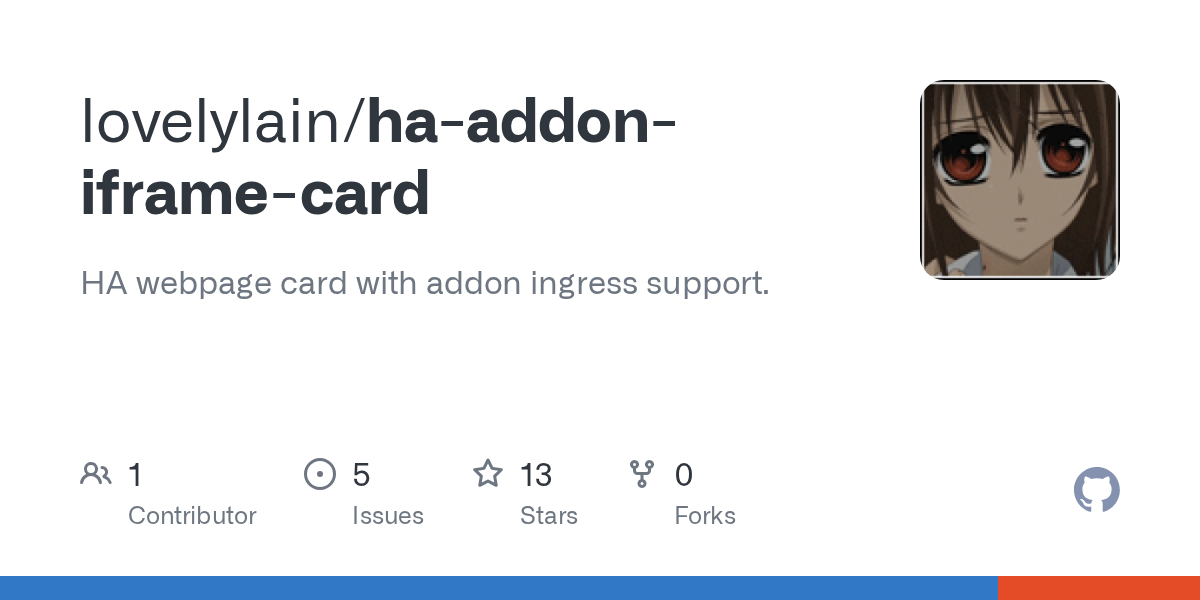

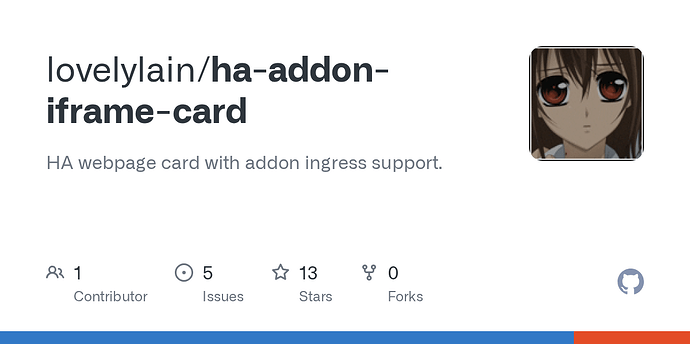

After more research I found this addon which seems to be working for me to resolve my iframe issues:
I found that the Ingress webpage card I had linked would not work the HACS and Browser Mod pages so I tried your tweak instead and it seems to be working well.
