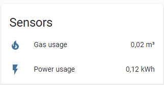

Hey, after a successful first attempt at monitoring my gas meter via a TCRT5000 (following the approach in Tracking gas usage with ESPHome, Home Assistant, and TCRT5000 | Savjee.be), I extended the YAML and the hardware setup and added a second TCRT, this time to my power meter.
Unfortunately I initially setup the template sensor as “device_class: power” (instead of energy), which resulted in a rediculously high sensor value/state:
[23:20:25][D][sensor:124]: 'Power usage': Sending state 1570730934272.00000 kWh with 2 decimals of accuracy
I fixed the code (device_class: power => device_class: energy), redeployed, but the problem is still that the sensor of course keeps the value from before.
How can I get a “fresh start”, aka: reset the sensor state/value to zero? I tried removing the code section completely, redeployed (which made the entity unavailable in HA), added the code section again, but after flashing the value is back. Of course I could add another sensor with a slightly different name and just ignore the botched one, but I’d prefer to use the original and just reset it.
How do I do that?
