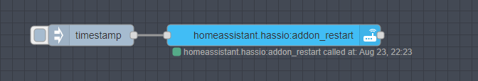

In the picture you did write addon_restart in the text you write restart_addon.
I tried both
None worked

I have HA (and NR as addon) running on an Odriod (I have no idea what that means in terms of supervised or dockers or foo.bar, but it works).
Reading your post, and out of curiosity, I tried the following service call - it works a treat. I wonder if the “quotes” make that much difference?

It is executing, but without realy restarting nodered
