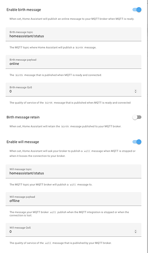

Could be a misconfiguration
MQTT config :
and Zigbee2MQTT status
So Zigbee2MQTT knows HA has restarted.

Setting → Devices & Services → MQTT → Configure → Reconfigure MQTT , second page.
Thanks you ar taking me to dark corners of config I had not previously seen :slight_smile:
Looks Ok
