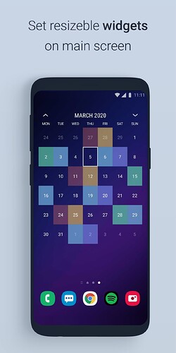

I am using the HA Calendar as the single source of truth, the calendars are displayed on multiple screens in the house and available on mobile devices.
HA does need to improve how this type of scheduling can be entered I currently use Shift Work Calendar Planner on my phone that does have a handy and good looking widget that can be placed on my home screen.
An entry method into HA would be ideal, being able to set custom shift times for each shift.
