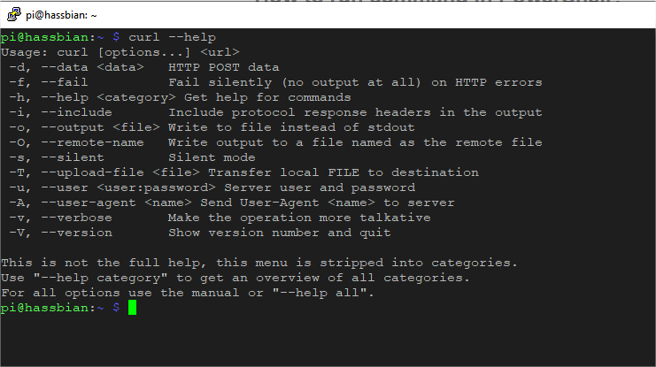

curl is available in windows shell
And also in a linux shell if you’re using Home Assistant (on a RPi for exemple).
