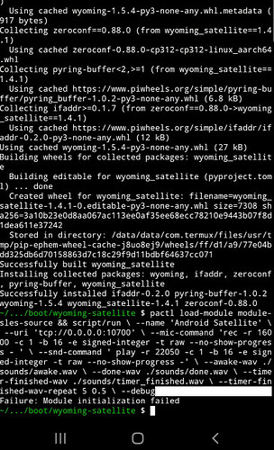

Hey folks, I am running into an interesting issue just getting wyoming satellite installed.
Here is what I have done.
flashed Lineage 15.1 on my TSV device. Works fine, for the device.
I then install f-droid client and from there install termux, termux:api and termux:boot
These all install fine afaik. I also install openssh since this makes life easier.
Here is where the fun begins. When I pkg install -y git python sox pulseaudio termux-api things start breaking upon installing python3.12
effectively this crashes termux, and then leaves python as an unconfigured package, resulting in the message to run dpkg --configure -a which subsequently crashes termux again.
~ $ pkg install -y python
