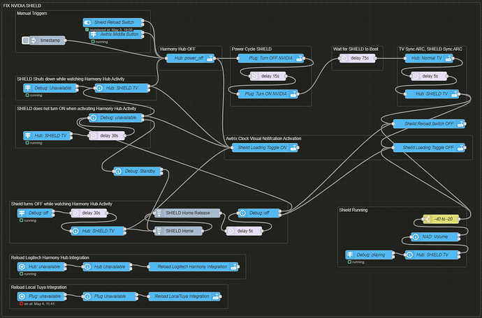

I have had to create the below overly complicated flow, to ensure my NAD Amplifier receives the ARC Audio Return Channel form my NVIDIA Shield, that is plugged into my LG WebOS TV.
