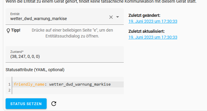

Today there is warning 38 and 247.
Unfortunately my code doesnt work as it should be:
- unique_id: "wetter_dwd_warnung_markise"
state: >
{% set current_count = state_attr("sensor.dwd_weather_warnings_current_warning_level", "warning_count") %}
{% set advance_count = state_attr("sensor.dwd_weather_warnings_advance_warning_level", "warning_count") %}
{% set warnung1 = 0 %}
{% set warnung2 = 0 %}
{% set warnung3 = 0 %}
{% set warnung4 = 0 %}
{% set warnung5 = 0 %}
{% if (current_count == 0) %}
Keine Warnung.
{% else %}
{% if (current_count > 0) %}
{% set warnung1 = state_attr("sensor.dwd_weather_warnings_current_warning_level", "warning_" ~ 1 ~ "_type") %}
{% else %}
{% endif %}
{% if (current_count > 1) %}
{% set warnung2 = state_attr("sensor.dwd_weather_warnings_current_warning_level", "warning_" ~ 2 ~ "_type") %}
{% else %}
{% endif %}
{% if (current_count > 2) %}
{% set warnung3 = state_attr("sensor.dwd_weather_warnings_current_warning_level", "warning_" ~ 3 ~ "_type") %}
{% else %}
{% endif %}
{% if (current_count > 3) %}
{% set warnung4 = state_attr("sensor.dwd_weather_warnings_current_warning_level", "warning_" ~ 4 ~ "_type") %}
{% else %}
{% endif %}
{% if (current_count > 4) %}
{% set warnung5 = state_attr("sensor.dwd_weather_warnings_current_warning_level", "warning_" ~ 5 ~ "_type") %}
{% else %}
{% endif %}
{% set warnungallg = (warnung1, warnung2, warnung3, warnung4, warnung5) %}
{% if "31" or "33" or "34" or "36" or "39" or "40" or "41" or "42" or "44" or "45" or "46" or "48" or "49" or "51" or "52" or "53" or "54" or "55" or "56" or "61" or "62" or "63" or "64" or "65" or "66" or "90" or "91" or "92" or "93" or "95" or "96" == warnung1 or warnung2 or warnung3 or warnung4 or warnung5 %}
{{ warnungallg }}
{% else %}
Unwichtig
{% endif %}
{% endif %}
Even there is no warning-type 38 or 247 selected, the wetter_dwd_warnung_markise sensor shows following warning:
It should be “Unwichtig”. I think the error is somewhere in the line:
Can s.o. pls help. Thank you!
Now i think i got it. I needed to check if array of string exists in another array
state: >
Keine Warnung.
{% else %}
{% else %}
{% endif %}
{% else %}
{% endif %}
{% else %}
{% endif %}
{% else %}
{% endif %}
{% else %}
{% endif %}
{% set a = [ 31, 33, 34, 36, 38, 40, 41, 42, 44, 45, 46, 48, 49, 51, 52, 53, 54, 55, 56, 61, 62, 63, 64, 65, 66, 90, 91, 92, 93, 95, 96 ] %}
{% set result = namespace(value=0) %}
{% for item in a %}
{% if item in warnungallg %}
{% set result.value = result.value + 1 %}
{% endif %}
{% endfor %}
{{ result.value }}
{% endif %}
