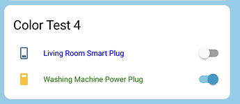

Remove the - from type: entities and adjust yaml spacing. This works with my switch entities:
type: entities
title: "Color Test 4"
show_header_toggle: false
state_color: true
entities:
  - entity: switch.living_room_smart_plug
    card_mod:
          style: |
            :host {
              color: blue;
  - entity: switch.washing_machine_power_plug
    card_mod:
          style: |
            :host {
              color: green;
EDIT: This code is for an Entities card in UI Mode
**EDIT2: I used this code to create an Entities Card in UI mode. This is how it looks in my Dashboard

Now I’m off to figure out how to make the name text colors conditional, based on the state of a separate binary_sensor… Thanks again, all!
OOPS!
After all that, my final post had the ‘entities:’ line in “Color Test 4” scooted over two spaces, instead of aligned under ‘state_color’.
Need more diet Coke. Fixed the indent, all is working…
