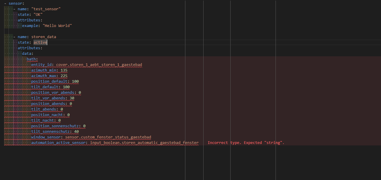

i tried, but my studio-code editor said:
Incorrect type. Expected "string".yaml-schema: http://schemas.home-assistant.io/integration-template
View Problem (Alt+F8)
i cant figure it out :frowning:
You can’t always believe those warnings… save the file, reload the config or restart HA then check it in the template editor tool.
i tried , doesnt work. :frowning:
{{ (state_attr(‘sensor.storen_data’, ‘data’)) }}
I don’t get those errors in VS Code.
Go to Developer Tools → YAML and select Check Configuration. If you get no errors, proceed to execute Reload Template Entities. Then check Logs for errors.

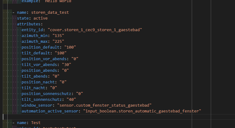

still there is no config data available. i tried Developer Tools → Template
If you tried it and it doesn’t work, there are errors in the log or the yaml file isn’t loaded to begin with. Any errors?
looks like the value has to be a string …
