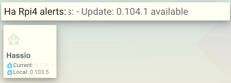

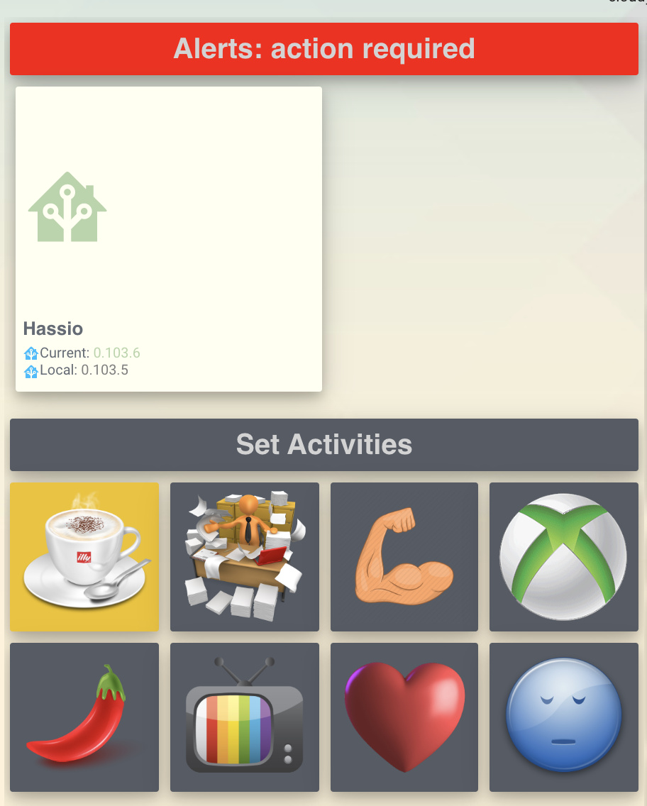

using a conditional set of custom button-cards, I am left with the challenge to set a max size to the (variable number of) buttons while also retaining aspect_ratio: 1/1
Now I ‘know’ a situation where all 4 cards would be alive together will never happen, so Ive aded a custom blank-card in there, otherwise a single alert card would even be bigger.

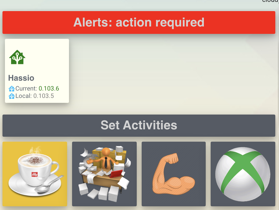

I’d love the cards to have a max setting as if 4 cards in the horizontal-stack would be alive.
Can this be achieved?
as an example the Alert setup as it is now, with 1 alert going on, together with the card below, with the desired 4 button size for comparison:

since the order of the alert buttons is now ‘fixed’, there seems to be a very small horizontal gap if the card are no displayed, and lets say the updater card only (like now) is shown.
