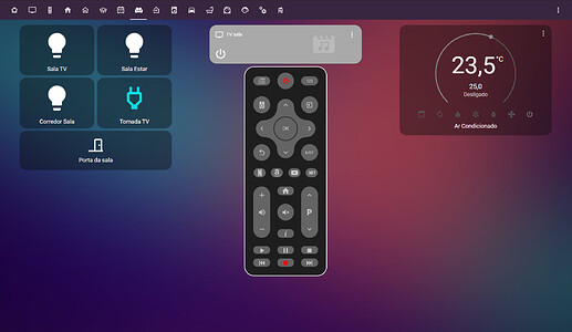

The dashboard of my livingroom was originally like this
but I started making some tests with layout card and then…
What I did was set the width of the view bigger then the width of the cards

I still want to make some changes but with this you can start changing yours too, if you liked it.
I tried and it works! Thanks a lot, @albieri you are amazing
