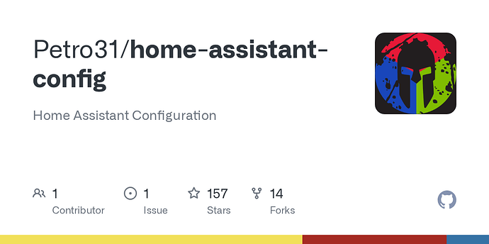

Here is my configuration for home assistant, backed up by git.
