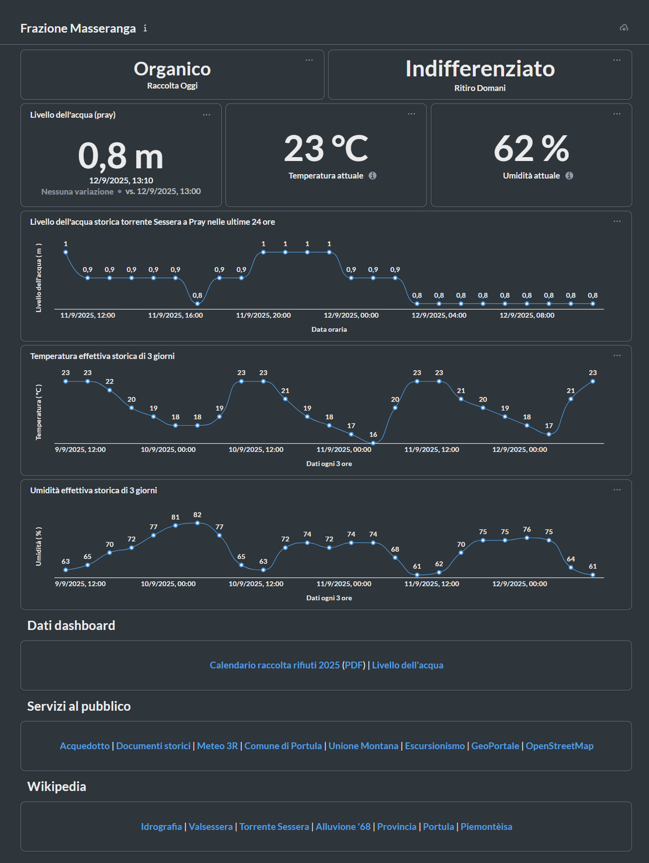

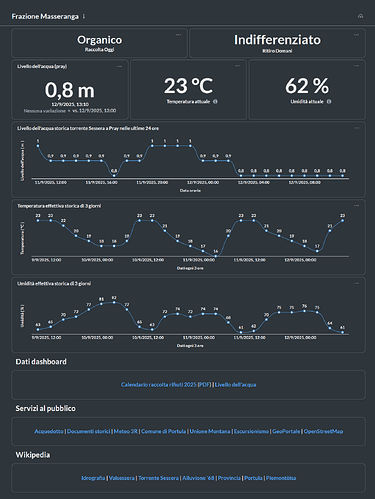

What worked for me was:
HA ~> n8n ~> PostgreSQL ~> Metabase
I built a public dashboard and share from metabase, the good thing about this I get the data from database optimized the bad thing is too technical.
I built this to share some important sensor with the community I live, which is very small:

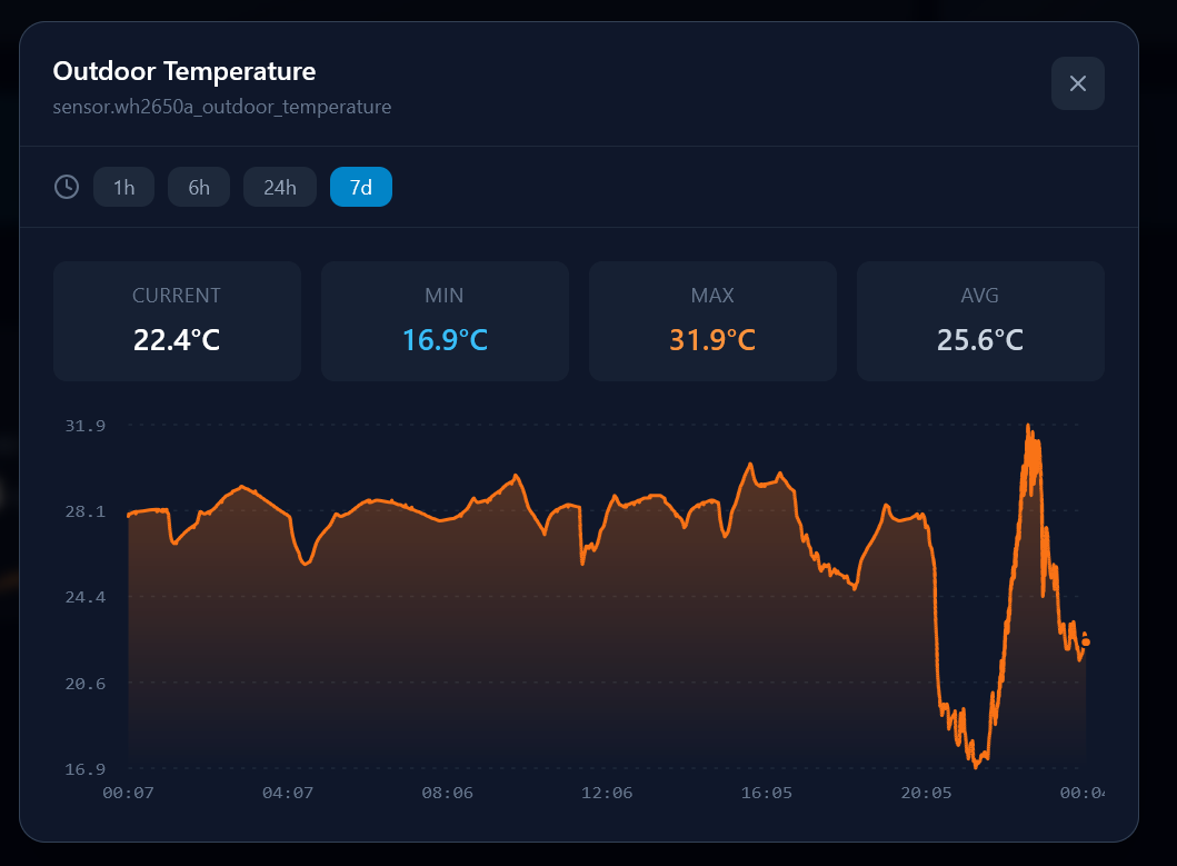

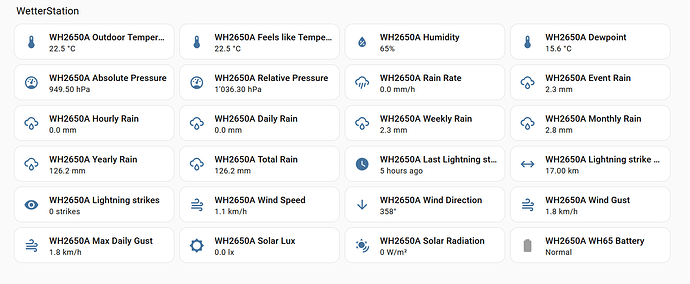

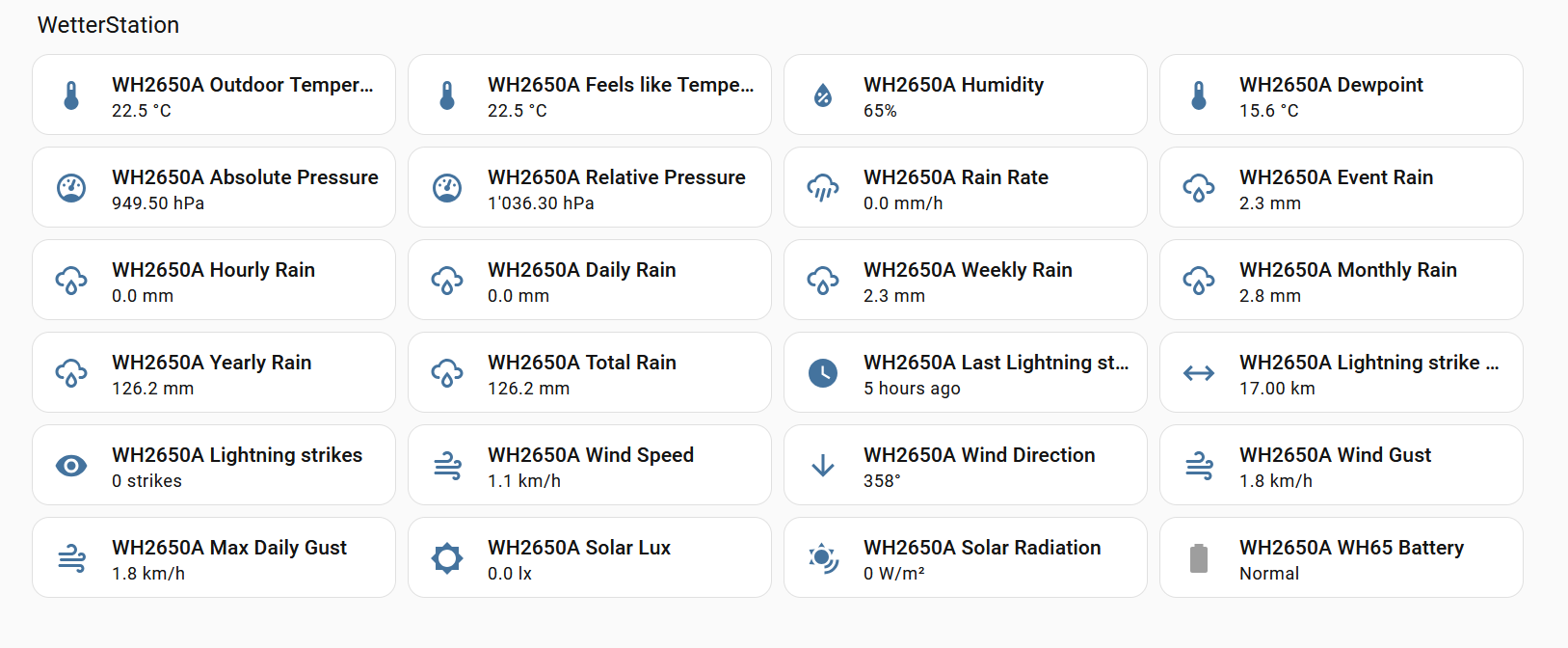

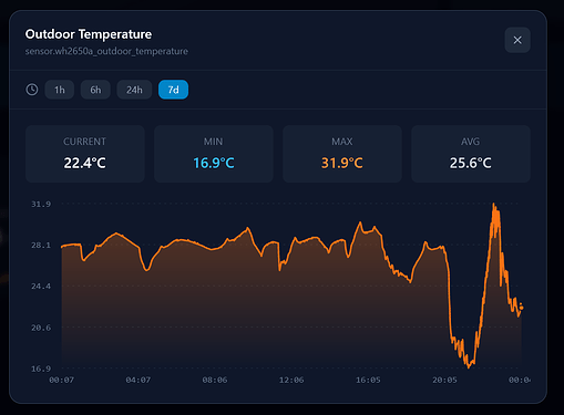

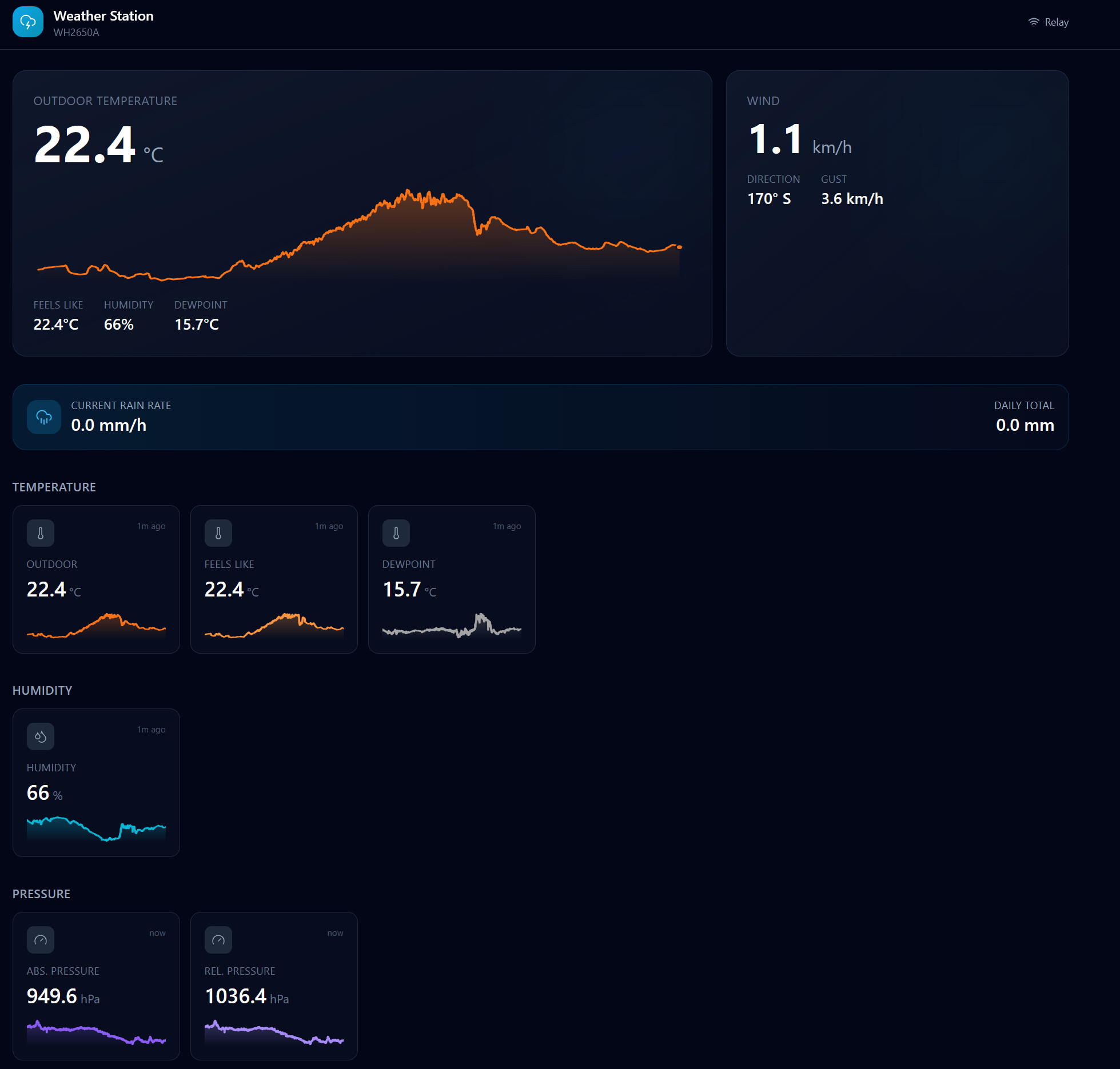

Soooo… i’ve been trying this Varco thingy.
Setup in Homeassistant was easy.
Trying to Build a Static Webpage not so much… ChatGPT and Gemini failed Horribly.
I Switched to Bolt.New Burned trough my credits REALLY fast… but good thing a CTRL+F5 in Chrome ignores the “You’ve used all your tokens.” prompt and let’s you continue^^
Went from this Dashboard:
to this website:
with Popups:
But the thing is, i want this as a PUBLIC Dashboard.
So i can send the Link to my Friends, and they can just Watch it whenver they want. No reason to wait until i approve the new Key Pairing. New Device? Just open the link and it works.
is there any way to do That? The AI horribly fails at that.
You DO have some way to make Preshared keys right? So People can just scan a QR-Code with the URL&Key and it instantly works because you have a pre activated Key. Right?
