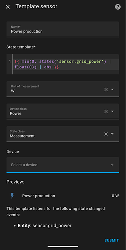

If you prefer to use the UI, the template helper can be used.

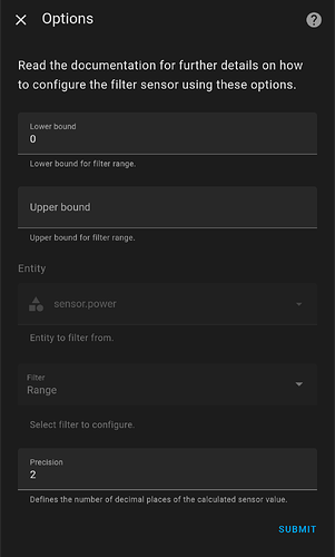

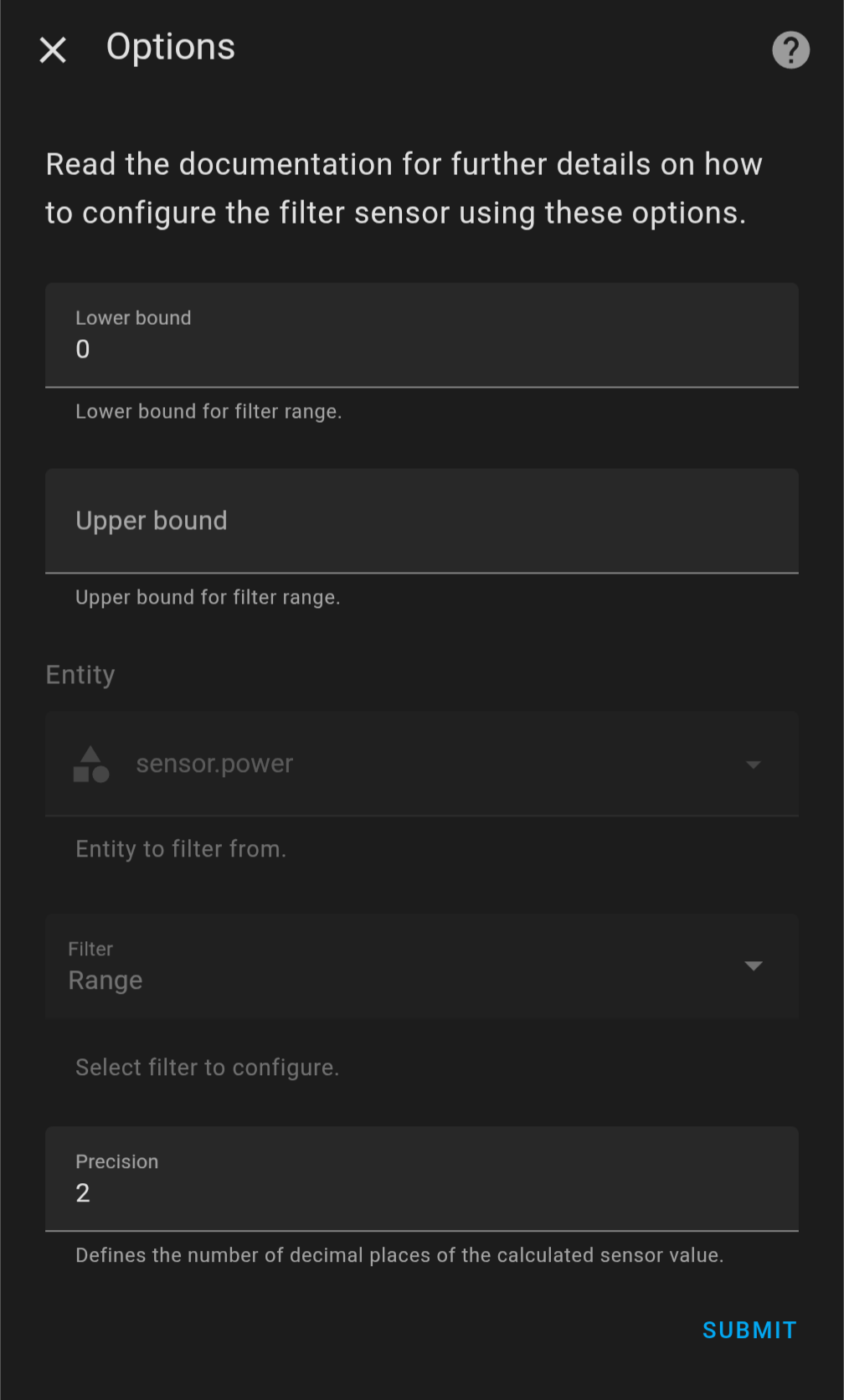

If no conversation math is required the filter helper can be used.

power:
 {% set power = states('sensor.netto_verbruik')|int
 {{[0,power]|min|abs}} # use `abs` to turn the negative power, return to grid, into a positive,
 {{[0,power]|max}}
