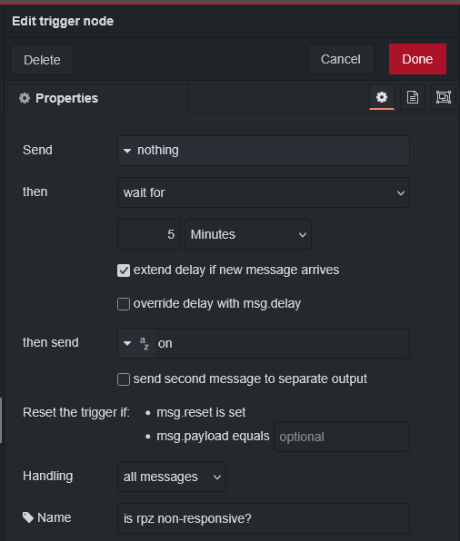

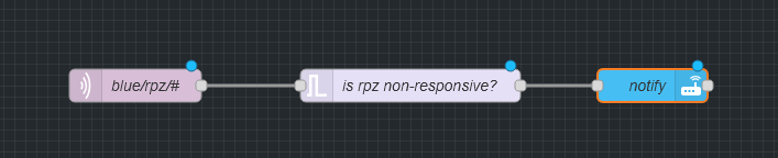

The way I handle this is with a trigger node. It is set to do nothing when a message arrives. Each additional message resets the trigger node timer.
If no new messages are received, the timer runs out and message is fired to trigger an alert that it’s not working.
Like minds and all that - that is exacty how i have it set just now.
Thanks
