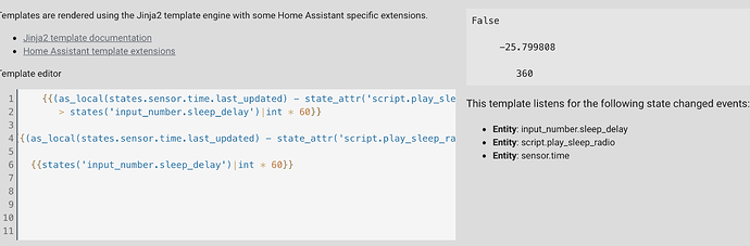

{{(as_local(states.sensor.time.last_updated) - state_attr('script.play_sleep_radio','last_triggered')).total_seconds()
             > states('input_number.sleep_delay')|int * 60}}
it should be seen correctly, a this is in the template editor:
restarting that before sensor, time has updated has its own peculiarities:

in various forms, depending on whether I use:
 {{max_playing_time - variables.loop_duration|int - states('input_number.decrease_volume_delay')|int}}
or variable.loop_duration|int or loop_duration|int .
Must be because it is used outside the loop of the while script then.
So, I have to revert to my original use of the wait_template. Which caused the error of the unsupported operand. Adding the |default(0) filter there helps:
      - wait_template: >
          {% set updater = states('sensor.time') %}
          {{(now() - state_attr('script.play_sleep_radio','last_triggered')|default(0)).total_seconds()
and, I can even us that in a template trigger for an automation, that stops the script on the other triggers. So cutting a few lines again.
What I have been wondering, is using a faster trigger in the template for updater than sensor.time. I have a sensor that updates on all energy state hanges in the system, which is way more frequent. Is there an easy way to determine the most updates sensor in the system? What template could we use to find that?
can make an empty automation and use that…
  - alias: Trigger per 2 seconds
    id: Trigger per 2 seconds
      platform: time_pattern
      seconds: '/2'
      delay:
        seconds: 0
to trigger
        {% set updater = states('automation.trigger_per_2_seconds') %}
          {{(now() - state_attr('script.play_sleep_radio','last_triggered')|default(0)).total_seconds()}}
update:
@amelchio suggested this:
         {% set delay = states('input_number.sleep_delay')|int * 60 %}
         {% set spent = (now() - state_attr('script.play_sleep_radio','last_triggered')|default(0)).total_seconds() %}
         {{ [0, delay-spent] | max }}
which works, without having the need for an updating entity_id at all…
nice.
