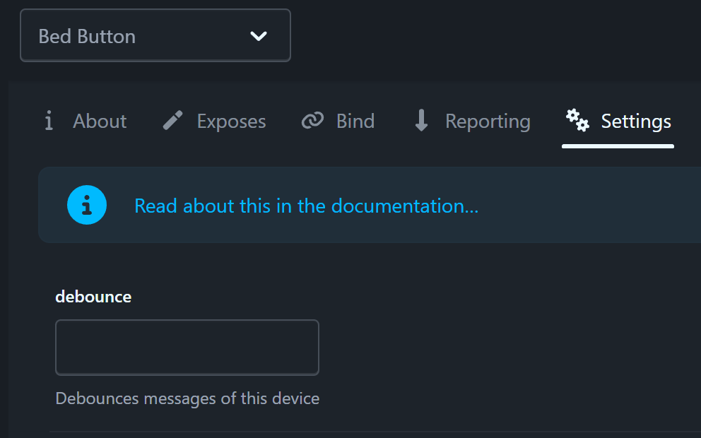

You can set debounce in Z2M too
Ooo Did not know could do this will give it a try
Throttle is probably a better option for your scenario vs a debounce value
Just trying to search on this. once found will try to implement
Adjusting Throttle is my best suggestion.
The minimum time between payloads in seconds. Payloads received whilst the device is being throttled will be discarded
throttle
Throttle processing of messages from this device. When setting e.g. throttle: 10 the first message from the device is processed but all other messages within the next 10 seconds are ignored. Be careful when using this option, unlike debounce that can ignore some attributes, this will drop the entire message.
debounce option has priority over throttle; if both are present for one device, only debounce will have any effect.
Setting this option reduces the number of MQTT messages sent for a particular device. This is directly linked to how high the option is set. When used on misbehaving devices with proper values, it can drastically reduce the size of external databases that store history (like Home Assistant), and yet have little to no impact on the quality of said history.

The settings I am referring too are in the Z2M UI, not the HA automation.
