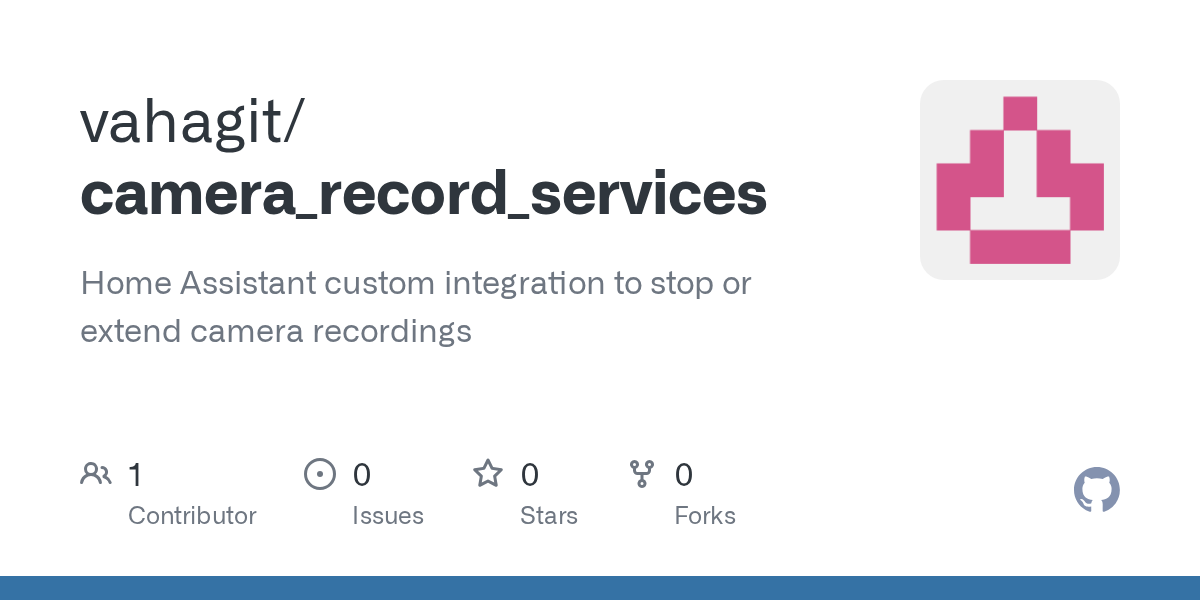

I needed both of these features for my automations. So I wrote an integration for it.
The integration provides two services:
  • camera_start_recording - a more configurable alternative to camera.record, which also lets you extend an already started recording (even one started by camera.record)
  • camera_stop_recording - stop a recording in progress, whether started by this integration, or by the built-in camera.record service
You can read the full details, with example uses, on the github repo.
