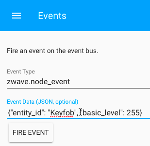

I followed the steps described here to activate a scene based on an event triggered by a zwave node (here a Fibaro Keyfob).
The automation code looks like:
- id: '1536096257102'
  alias: Test Automation
  trigger:
  - event_data:
      basic_level: 255
      entity_id: Keyfob
    event_type: zwave.node_event
    platform: event
  condition: []
  action:
  - data:
      entity_id: scene.nuit
    service: scene.turn_on
When I press to correct button on the keyfob, the zwave logs indicates:
2018-09-04 23:43:47.054 Info, Node012, Received Basic set from node 12: level=255.  Sending event notification.
2018-09-04 23:43:47.054 Detail, Node012, Notification: NodeEvent
When I manually trigger the event on Home Assistant, the scene gets activated correctly:
Therefore, I strongly believe that is is just a matter of setting the ids correctly.
Is there a way to “tail” the events Home Assistant receives / generates to control that?

Think your entity_id is wrong. Entity id’s will have a domain and a name. You are just using a single capitalized name.
I would expect your entity id to be something along the lines of 'sensor.keyfob'.
Also, you should verify that basic_level is an attribute passed in the event.
you were right, the correct value was: zwave.fibaro_system_fgkf601_keyfob
Thanks for the tip. I really think that the Configurator is brilliant. It allowed me to find the correct entity_id.
