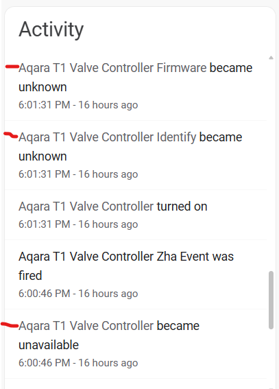

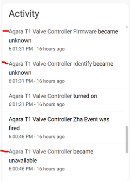

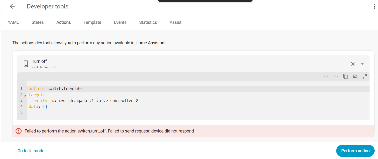

I have an Aqara T1 valve controller that occasionally becomes unresponsive. I can see in the device “Actions” that the state is unknown and sometimes unavailable. Also, in Developer Tools I ran an action and got the “Device did not respond” error shown below.

the device will be responsive when unknown. When it goes unavailable, you’ll likely get that error.
You can make an automation notify you when the device goes unavailable. A simple state trigger looking for the state “unavailable” will work.
