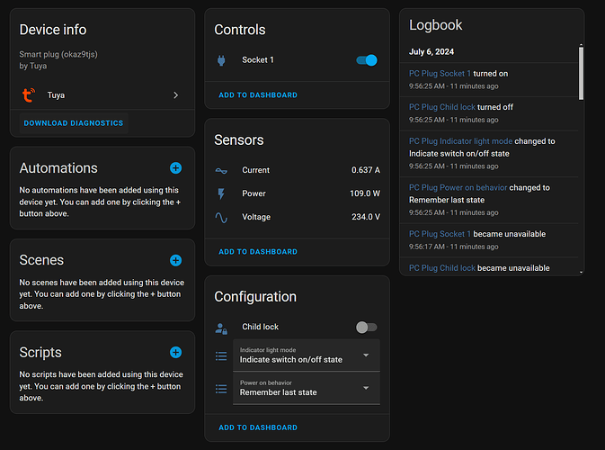

This is a Zigbee Smart Plug (Smartrul brand) under a Zigbee hub linked to a Mini PC.
I have tried searching and couldn’t get it working…
The energy consumption is showing in Smart Life application but not on HA.
