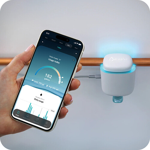

It's not cheap, and you need access to clamp it to the water line (and power near that) but you can get two of these:
You have to use their app to onboard the device, but it does support an HA integration. The only trick with two of them is that in their app you have to setup two separate houses. In HA they just both appear.
I'm using two of these just to detect hot water flowing to two showers (for presence detection basically). It's not their intended use, but they've worked really well for me.
