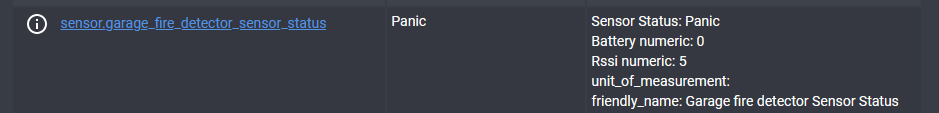

In dev-tools states tab I can see this sensor having this kind of attributes
