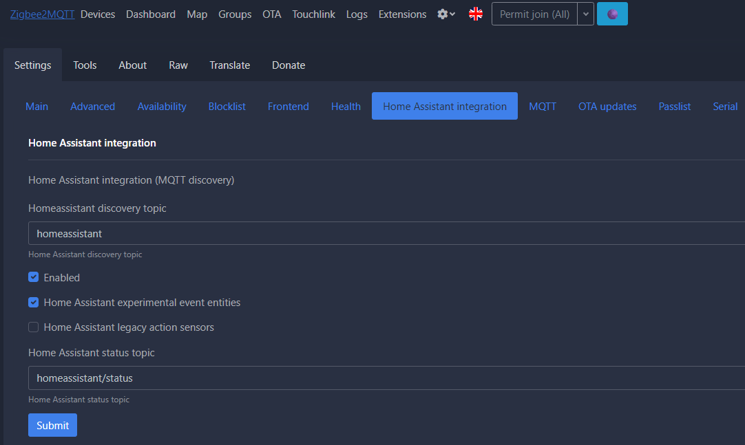

Are you running Zigbee2MQTT on the same RPi where the USB dongle is plugged in? If that is the case, you do not need ser2net at all. You would point Zigbee2MQTT directly at the USB port on the RPi. After it’s setup to connect to the USB port directly, and Zigbee2MQTT is running on the RPi, you connect to Zigbee2MQTT via a browser at http://192.x.x.x:8080 (the address of the RPi), and make sure to set the Home Assistant integration to enabled. Then HA should auto-detect it as an MQTT integration.
