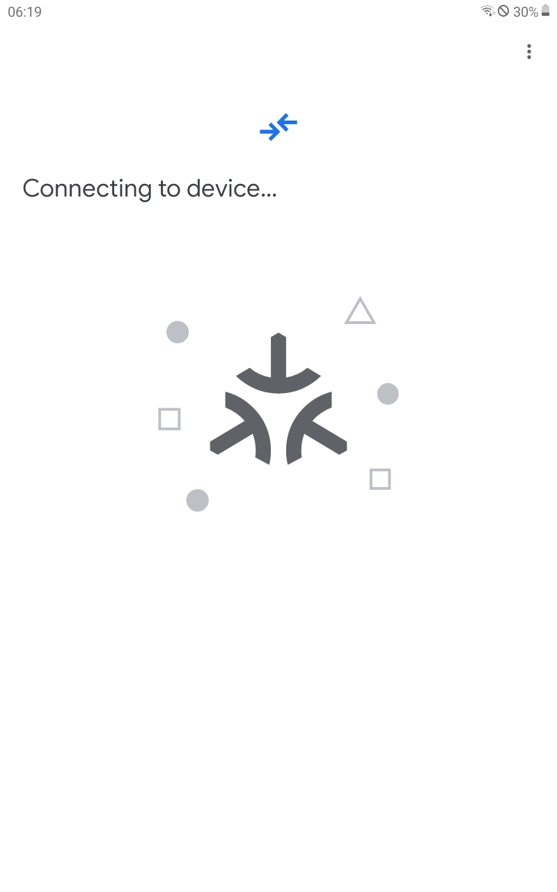

I recently got a BILRESA E2489 remote control from IKEA and I’m trying to set it up.
I have ghcr.io/matter-js/python-matter-server running with host networking and Home Assistant is connected to it:

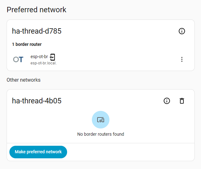

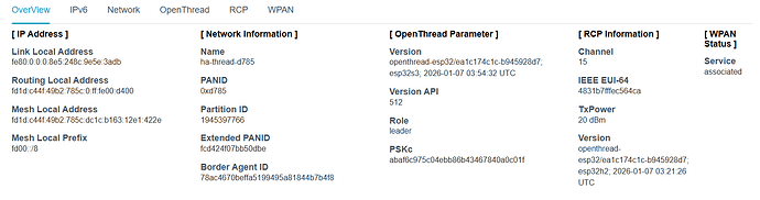

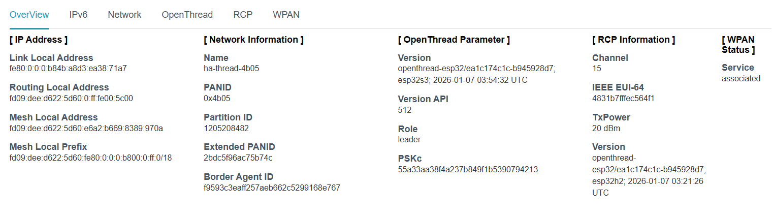

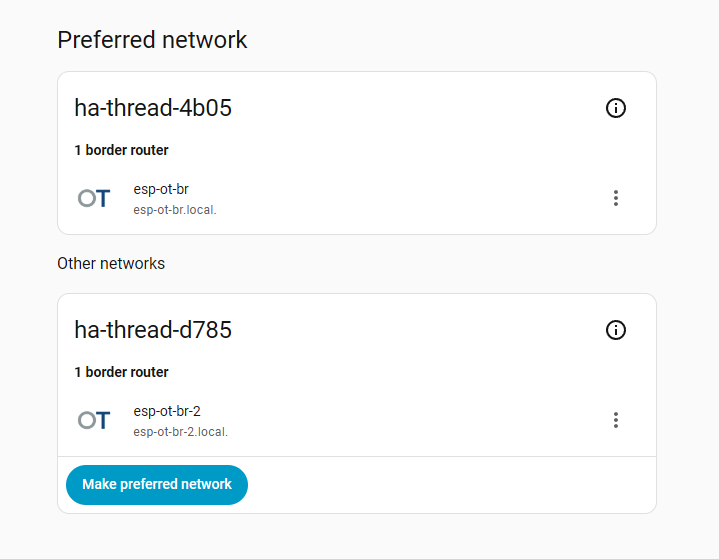

I have two ESP border routers running, I have configured them using the Open Thread border router integration and they appear in the Thread integration:
Currently they are both sitting on my desk next to the remote control.

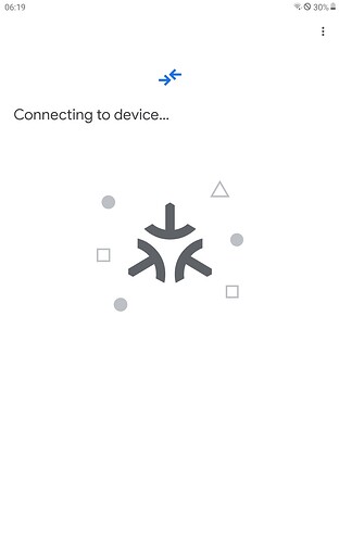

I pushed the button inside the remote and it is flashing yellow. I opened the device settings in the Android companion app and selected Add Matter device. Then I scanned the QR code on the remote and I get this:
Now what?

There are actually different screens that I’m getting. Mostly it says “Searching for device…”, sometimes it says “Connecting to device…” and once it said “Your device requires a border router”. (You don’t say!)

After a Home Assistant update I was now able to sync credentials successfully. Currently I’m only getting “Searching for device…” though.
As a first, having 2 Thread networks is probably not what you want.
You should “join” one to the other through the OTBR webui.

I want to install the border routers in two places where they are not in range of each other. Should I still join them? I assumed joining means they will communicate though Thread, not through the LAN.
That’s kind of what I’m trying to do but I don’t know which addresses and routes should be there.
That’s what I assumed as well, but my tests have shown that HA somehow link them (through LAN), although they cannot communicate in Thread.
A device I use as a test indistinctly connect to the OTBR it sees, because they all are part of the same Thread network.

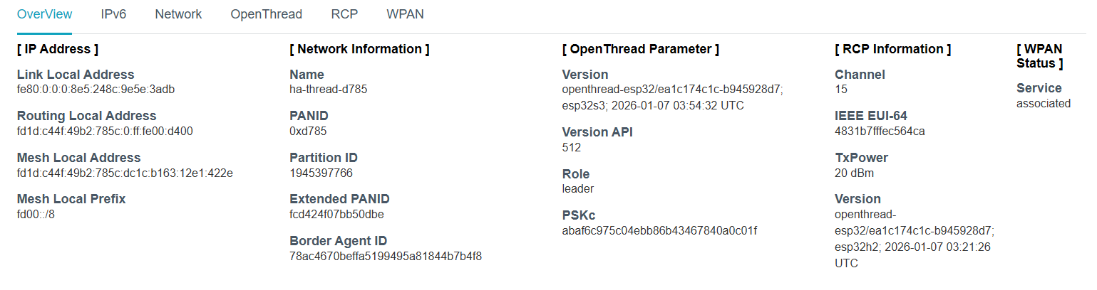

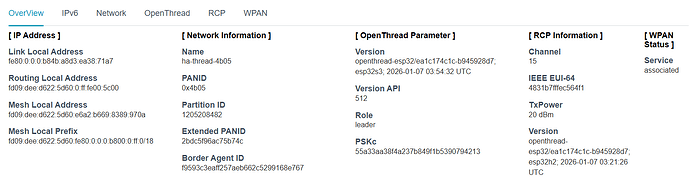

May I ask, where did these screen shots come from? I haven’t seen these before… Is this from the OTBR Web GUI?
Do you mind posting an updated screenshot or your Thread Integration’s Preferred/Other Networks? I’m looking for an icon of a “key in a phone”.
One possible reason for your Android HA CA to be “searching for device”, is that it is probably looking for a mDNS advertisement to show up on the LAN (and WiFi) side of the OTBR. Is your Android on the same network as HA? If it is, then chances are that the device was either not given the correct set or no set of Thread credentials and thus was not successfully added to the Thread network.
Yes.
Ah yes, that icon does appear sometimes, usually on one of the two border routers but also sometimes on both. I have turned one off for now, ran another credential sync and it currently looks like this:

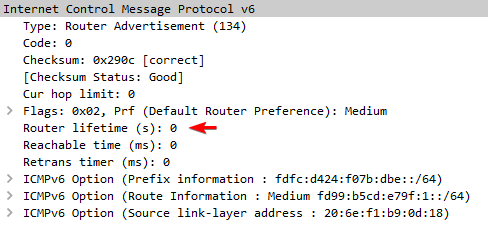

I have started to read up on what the network should look like. Apparently the border routers are supposed to send RAs for the prefix of their Thread network and the HA server is supposed to add that to its routing table? One thing I noticed is that they always send a lifetime of 0.
Is that normal? In normal IP networking it means the router wants to deprecate this prefix if it was previously set, so IMO my HA server acts correctly when it does not add this router to its routing table.
I sorta forgot that you have two separate Thread networks and thus two set of Thread Credentials that are in play. This may be a problem, but I don’t know. I don’t really know what happens in Android when syncing two sets of credentials like this. I should note too that when Android stores Thread credentials, it stores them against a Thread Border Router/Network (thus the key in a phone icon), so you would need to have both Thread networks with a key in phone icon (but not sure if HA will let you do that?). Most likely Android can store both set of Thread Credentials, but there are two problems I can think of:
  • When its time for commissioning, how will Android know which Thread network to commission on? It will go looking for TBR mDNS advertisements and will see two of them, so how does it pick?
  • However, the most common problem is that Android generally only uses the first set of credentials it ever gets, so to be honest, I have doubts that Android can handle two separate Thread networks.
For sure what will work is to put both OTBRs in the same “Preferred” network, and pick one of them for the key in a phone icon.
I think that specific router lifetime is an advertisement about the router itself to say “don’t use me as a gateway”. The prefix lifetime should be in the option “Prefix information”.
Having two OTBRs, each wanting to send out their own prefix to HA, one will “defer” if it sees the other’s prefix being advertised, so it maybe such that one of the prefix advertisements needs to be cancelled and has its prefix lifetime set to 0 as part of the “deferring”.

Hm, ok, yes, there is a prefix lifetime there. So this route should be sufficient?
Destination                    Next Hop                   Flag Met Ref Use If
fdfc:d424:f07b:dbe::/64        [::]                       U    303 5     0 wlan0

Somehow the device (the little Thread remote control) gets this IP address, fd99:b5cd:e79f:1:bc2c:b6c5:e5f8:bfb9. This is from the range that the border router is advertising (fd99:b5cd:e79f:1::/64). (I don’t understand yet where this space comes from and how and by whom an IP address gets chosen from this space for the device.)
Then the matter-server tries to contact the device on this address. This fails because my HA server did not register the route that was advertised.
I will investigate why that is.
That was because dhcpcd handled RAs, but it doesn’t handle RIOs. (By the way, I saw the term “RIO” in logs and conversations before, but I only just realized that it’s not a Matter term but simply means “Route Information Option”, from the Neighbor Discovery.) So I disabled IPv6 in dhcpcd and let the Kernel handle RAs.

I think you made the same mistake as I did. The button “Make preferred network” simply swaps between “preferred” and “other” networks - I had tried that button before. But because of your comment I looked again and I found a menu option in the border router ⋮ menu that said “Add to preferred network” and that indeed reconfigured the second border router to be in the same network. :+1:
