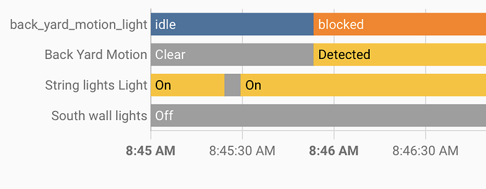

I tried setting this up with Entity Controller but I have a problem: If any one of the 4 lights is on when the motion triggers, Entity Controller enters blocked state and does not turn on any of the other lights. This history graph illustrates the problem. This integration looks pretty thorough so I’m guessing there is a way to achieve this, I’m still searching for it…
This is my config:
entity_controller:
  back_yard_motion_light:
    sensors:
      - binary_sensor.back_yard_motion_detected
      - binary_sensor.front_yard_motion_detected
    sensor_type: duration
    entities:
      - light.south_wall_lights_light
      - light.patio_string_lights
      - light.front_porch
      - light.garage_outdoor_lights
    delay: 120

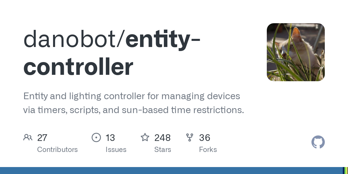

I also found that Entity Controller has the exact same problem: Feature Request - option to disable motion trigger during timeout · Issue #40 · danobot/entity-controller · GitHub
