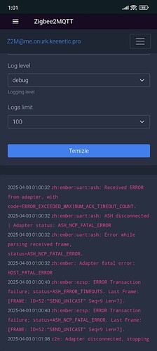

Hi
I followed the given instructions, but I keep getting an error during the update.
