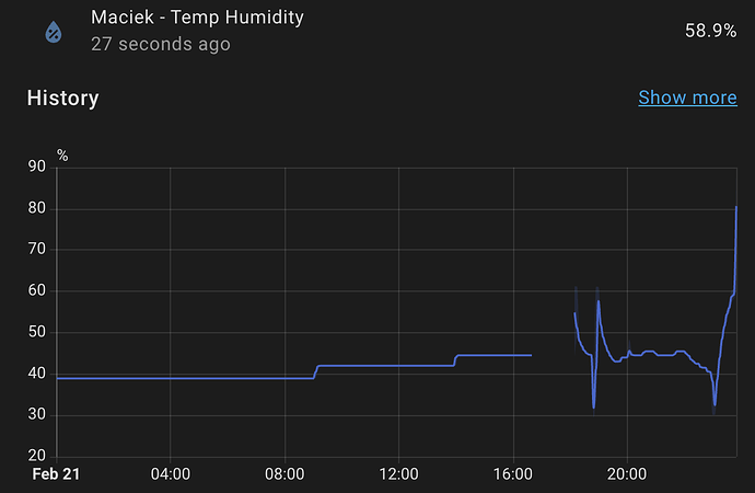

there is an update - installing it now.
Update worked, and I was able to reconect to HA.
Nice. Can you share your experience about the update frequency/threshold? Still 0.2K? Also have you noticed a change on the humidity accuracy? Mine are always 5%relh offset
not sure how long it will last, but for now it looks good. Took sensor few times outside and it updated immediately.
this is another sensor - clearly after update it refreshes frequently
