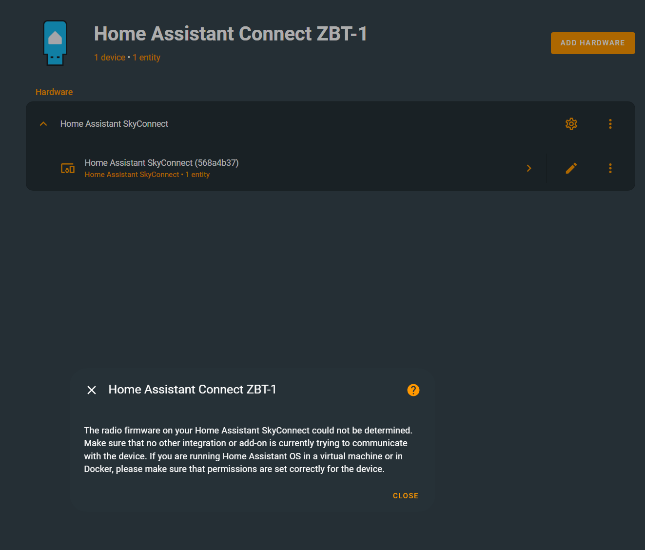

I’m using HA Docker and the integration shows this error even if the zigbee key works correctly:
once I shut down the zigbee2mqtt service, I was able to upgrade
