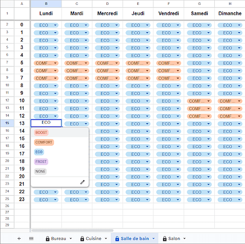

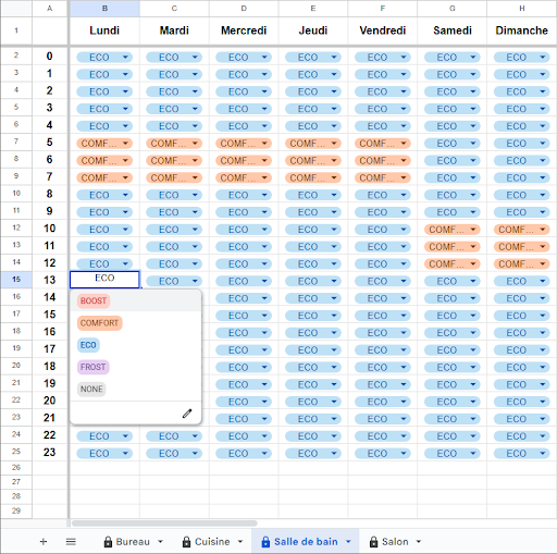

1/ Create a spreadsheet in Google Sheets
  • 1 sheet per room
    • Important: The names of the rooms must match the names of your Versatile Thermostat and Radiator entities
  • 1 column per weekday
  • 1 row per hour of the day
  • The first row and the first column are frozen
    • Easier to navigate on a smartphone
  • Data validation rules

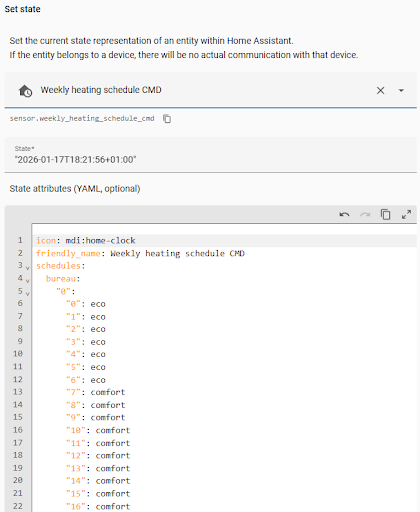

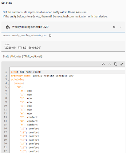

In ‘Developer Tools’, click on the tab ‘YAML’, then ‘All YAML Configuration’.
In ‘Developer Tools’, click on the tab ‘States’, then search for ‘Weekly heating schedule CMD’.
You should get the following result:

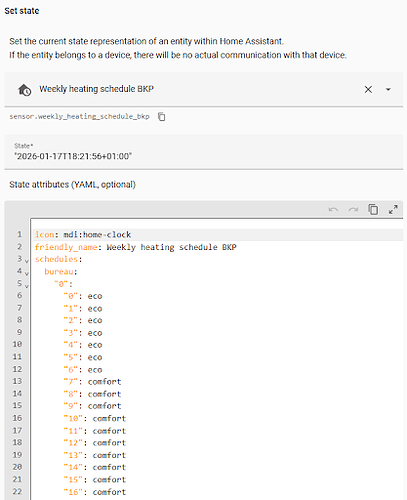

In ‘Developer Tools’, click on the tab ‘States’, then search for ‘Weekly heating schedule BKP’.

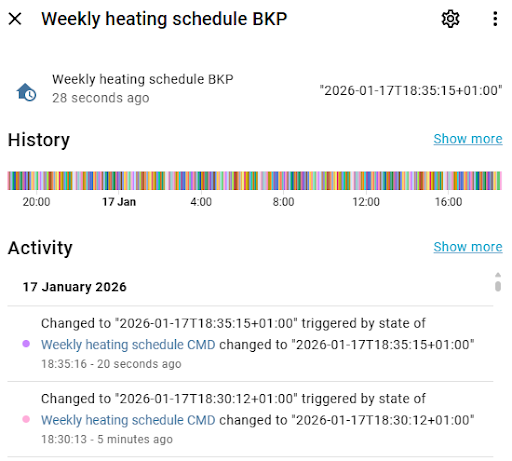

In the ‘Weekly heating schedule BKP’ entity, we can see that the schedule data is copied from the ‘Weekly heating schedule CMD’ entity when the latter changes state.
