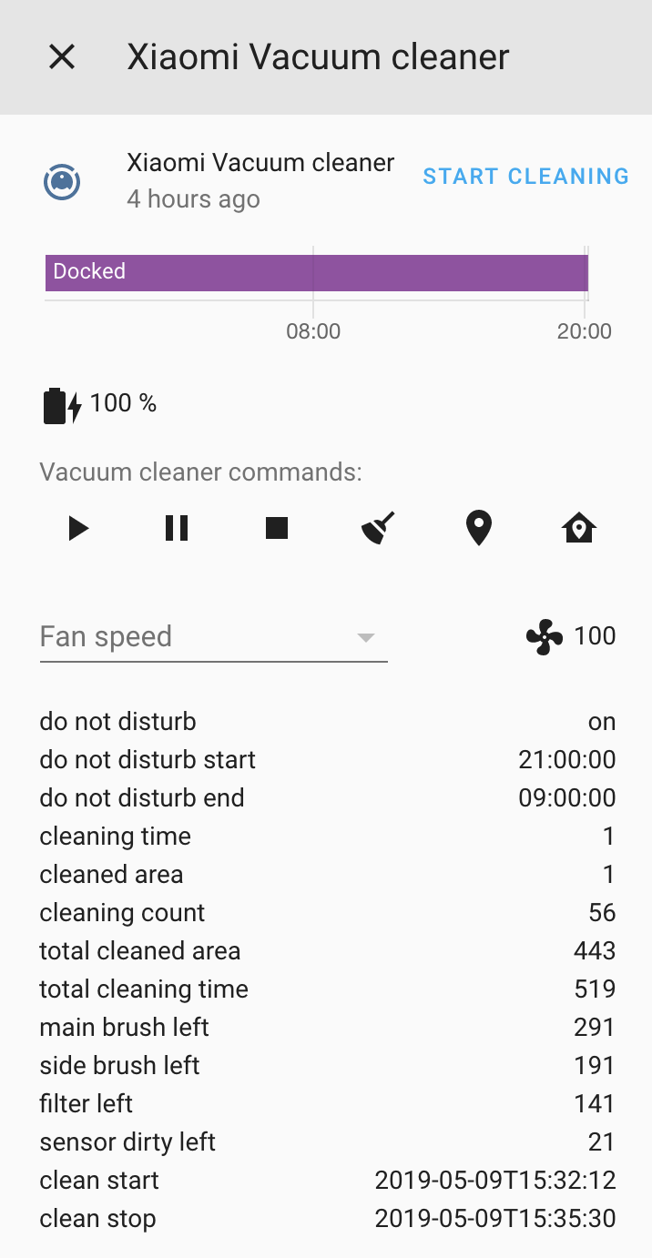

I am trying to create a card that will display how many days ago ago my Xiaomi vacuum cleaner was active for the last time. First thing I tried was to use the history data, but havent managed to get out the correct value.
Different approach would be to use the devices “last used” attribute (YYYY-MM-DDTHH:MM:SS) and subtract it from the current time and date. But I have no clue how to do it.

Thanks a lot! I think I am close, I changed to code, as with device_class timestamp I got “invalid date”:
platform: template
sensors:
last_vacuum:
friendly_name: “Last Vacuum”
unit_of_measurement: days
value_template: “{{((as_timestamp(now()) - as_timestamp(states.vacuum.xiaomi_vacuum_cleaner.attributes.clean_stop)) / (3600*24)) | round(1) }}”
However, the calculations are still not correct. Right now I get a value of 0.17 days, which does not equal the 6,5 hours since the last cleanup…
