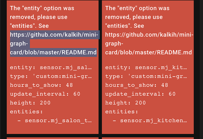

So, I’m very sure that my last attempt is almost perfect. My only problem is that auto-entities is injecting the value into the card as entity while the card expects a list of entities, even if it is of a single entity. If I had just a way to tell auto-entities how to inject the entity it will be 100% perfect
Dam it, I was so close (and the feature was so hidden on the docs…).
Seems that you can use an specific string on the options of the auto-entities and it will inject there the entitiy name:
In the options: option of the filters, the string this.entity_id will be replaced with the matched entity_id. Useful for service calls - see below.
This was almost perfect for my use case, I couldn’t believe it was so convenient…
However, this is what I encountered:
The mini-graph-card fails if you provide an entity option, and auto-entities will inject it even if you use the previously mentioned feature.
I wish cards just ignore whatever they don’t want to take into account, instead of failing and making life hard for their users.
Finally!
I thankfully, as a developer I had an intuition. I thought that, if I provide an entity value the auto-entities will not inject it, and I thought that if the value were undefined the mini-graph will not detect it so I added an empty entity: entry… and it worked!
This is my final card definition:

My missing key is:
options:
  entity: null
    - this.entity_id
This is to ensure that auto-entities not pass “entity” attributes to mini-graph-card and passed it on entities.
