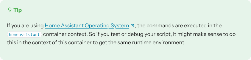

Create shell commands to call your curl commands. You can then call these shell commands as actions in your automations, scripts and dashboard buttons.
Take particular note of this:
