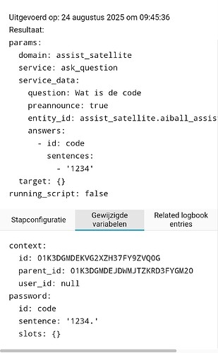

I made an automation where i have the assist satelite ask a question , i can set the answer , but no matter if the answer is wright or wrong , the automation continues to the next step.
It is set to create response_variables , and this contains
Sentence: 1234
It changes the state of the variables , if wright it is like:
Sentence: 1234
If wrong:
Sentence: null
How can i make a step that is checking the changed variables?

I need an extra step to check the variables before disarming the alarm.
This shows up in the step details:
actions:
  - action: assist_satellite.ask_question
    metadata: {}
      question: Wat is de code?
      preannounce: false
      entity_id: assist_satellite.aiball_assist_satellite
    response_variable: answer
  - if:
      - condition: template
        value_template: "{{ '1234' in answer.sentence | lower }}"
    then:
If a stricter condition is required
  - action: alarm_control_panel.alarm_disarm
    metadata: {}
      code: "{{ answer.sentence }}"
      entity_id: alarm_control_panel.home_alarm
