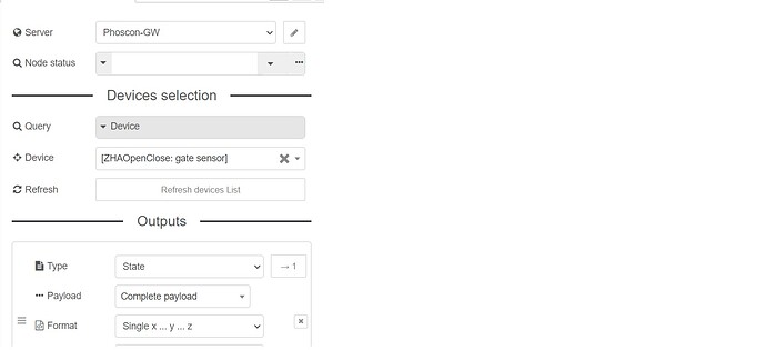

these are the possible settings for the sensor:
No possibility to choose “State Closed”
Next picture is the settings of the switch plus the debug of the sensor.
No debug results at the output of the switch
Am I missing something?
try use Trigger = Device … device = gate-sensor
And it’s the actual reported “State” you use, in this case true/false
PS: true/false might be an Attribute thou, in this case … i don’t know that Device , you better check in Developer Tools /State, … Don’t post pics from NodeRed, when you don’t seems to have issues with NodeRed
Maybe you can change the payload in NR, i don’t know nothing about NR
Did you see a “State Open” ? , if so you might need an “condition” if -State Open = true/false
Thank you again for your help with this problem
With your suggestions I managed to make it work.
The trick was indeed in the true/false department, when I changed the “payload” of the sensor to “state open false” a switch with this values made it work.
