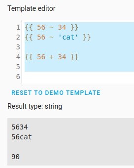

  • The tilde (~) concatenates strings. Even if you provide numbers, they will be handled as strings.
  • The plus sign (+) adds numbers. If there are no numbers, only strings, they will be concatenated. However, an error will occur if there is a mix of numbers and strings.
Notice the difference in how the two operators, ~ and +, behave:
Screenshot from 2021-01-10 15-49-57

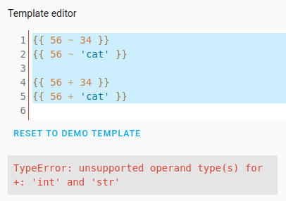

If I add the template {{ 56 + 'cat' }} it results in an error because I am instructing it to add a number to a string.
Screenshot from 2021-01-10 15-54-17
