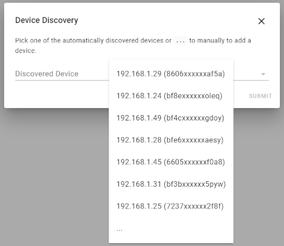

I see the local IDs of my devices in the Tuya IoT website, but the local tuya integration can’t detect them or connet with setting the IDs manually.
This is not working for me:
For me it looks like this:
So, my question is how to get this devices into local Tuya, if local Tuya can’t detect them?
I have the same issues with non-detection, just add the stuff manually, i.e. click Absenden and then ip+id+localid

I tried several times to add the devices in local tuya manually, but get always get this error message. But dDevice ID, local ID and local IP address are correct.
