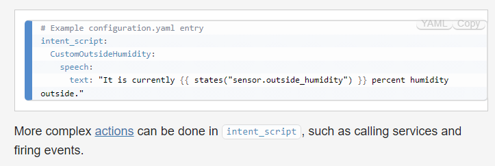

For my use case I will try intent_script
Update:
Unfortunately, I believe that intent_script cannot call other scripts in turn.
Therefore, I cannot use a word or a sentence to activate/run/trigger a script/automation?

They definitely can… as Tinkerer stated, you should be using a script if you don’t have a trigger.
conversation:
  intents:
    GoodnightRoutine:
      - "Goodnight"
intent_script:
  GoodnightRoutine:
    speech:
        text: "Running Goodnight routine"
      service: script.goodnight_routine
For existing automations using the automation.trigger service works as well*
intent_script:
  GoodnightRoutine:
    speech:
      service: automation.trigger
      data: {}
        entity_id: automation.goodnight_routine
* The automation.trigger service bypasses conditions by default and does not create a trigger variable so it is not appropriate for use with automations that rely on trigger-variable-based templates or trigger-id-based conditions.

Yes, thank you! When I wrote the update note I converted the automation into a script.
Then I didn’t know how to link a script to the intent_script because of the lack of explicit documentation about it. If there is, please point it out, thank you very much!
Thank you also to @Didgeridrew, I’ll try to add action.service=script.my_script
