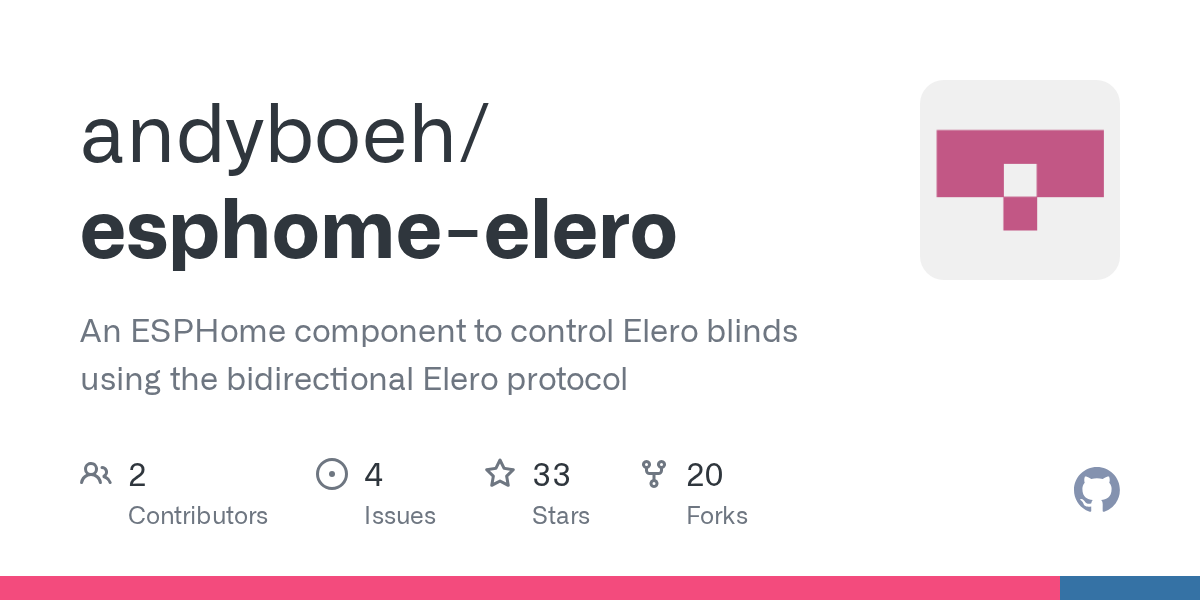

The last discussion references this library (and they use it), which is now unmaintained, but seems to be working for some:
This would be a low-cost alternative to the following option, if it works decently…

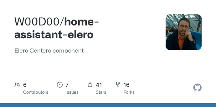

I also saw this library, which is for the Centero and USB transmitter stick. But these are crazy expensive from what I found (>400 Euros):

The advantage of the RolMotion wireless is that you can always switch to wired mode if you have the proper cable. So my advice is to run 4-conductor cables in all cases so that you can implement central control later if you really want to go wireless. We replaced all cables with 5-conductor ones, that was quite challenging. Since there are some junction boxes, I had to run 18-conductor and even 25-conductor cables to the junction boxes in order to support all motors. The fact that my wireless system is gone is the reason why esphome-elero is unmaintained.

The USB Transmitter Stick is discontinued and AFAIK not available anywhere - you might find one on the used market. The Mediola v4 and upwards support Elero and can be found way cheaper, but there is no easy HA integration (only a discontinued one by me, mediola2mqtt; and someone succeeded with HTTP commands).
