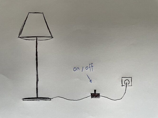

How would you make stupid lamp smart (see image)?
Hi all,
How would you guys make floor lamp (or any device with a manual switch) smart? For me having for example a smart switch at the socket and only using it over this smart switch is not “smart” any device should work manually as well.
Are there any solutions / great ideas on how to solve this issue?
Best,
Mike
Cut the switch out and use a Shelly1 in a Shelly button case.
