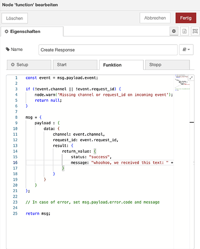

And here is an example flow to catch the triggering event and send back a response:
[{"id":"39e2fe3bbdb749b2","type":"group","z":"64f4dc3ef013c268","name":"Sample flow for \"Node-RED Request\" script","style":{"label":false,"stroke":"none","fill":"#d1d1d1","fill-opacity":"0.5"},"nodes":["941395bc8d0c662e","e672de2c700fcbe5","0435f612e7c930af","687bb6fa2765cc5e","0f763b21a2ea8fd9","db8d6d2a9142a672"],"x":14,"y":319,"w":1052,"h":142},{"id":"941395bc8d0c662e","type":"server-events","z":"64f4dc3ef013c268","g":"39e2fe3bbdb749b2","name":"","server":"ef6aa0b.3fe4a6","version":3,"exposeAsEntityConfig":"","eventType":"nodered_request.trigger","eventData":"","waitForRunning":true,"outputProperties":[{"property":"payload","propertyType":"msg","value":"","valueType":"eventData"},{"property":"topic","propertyType":"msg","value":"$outputData(\"eventData\").event_type","valueType":"jsonata"}],"x":170,"y":420,"wires":[["687bb6fa2765cc5e"]]},{"id":"e672de2c700fcbe5","type":"ha-fire-event","z":"64f4dc3ef013c268","g":"39e2fe3bbdb749b2","name":"","server":"ef6aa0b.3fe4a6","version":0,"event":"nodered_request.response","data":"","dataType":"jsonata","x":900,"y":420,"wires":[[]]},{"id":"0435f612e7c930af","type":"function","z":"64f4dc3ef013c268","g":"39e2fe3bbdb749b2","name":"Create Response","func":"const event = msg.payload.event;\n\nif (!event.channel || !event.request_id) {\n    node.warn('Missing channel or request_id on incoming event');\n    return null;\n}\n\nmsg = { \n    payload : {\n        data: {\n            channel: event.channel,\n            request_id: event.request_id,\n            result: {\n                return_value: {\n                    status: \"success\",\n                    message: \"whoohoo, we received this text: \" + event.payload\n                }\n            }\n        } \n    }\n};\n\n// In case of error, set msg.payload.error.code and message\n\nreturn msg;","outputs":1,"timeout":0,"noerr":0,"initialize":"","finalize":"","libs":[],"x":650,"y":420,"wires":[["e672de2c700fcbe5"]]},{"id":"687bb6fa2765cc5e","type":"switch","z":"64f4dc3ef013c268","g":"39e2fe3bbdb749b2","name":"Are we the receiver?","property":"payload.event.channel","propertyType":"msg","rules":[{"t":"eq","v":"test-flow","vt":"str"}],"checkall":"true","repair":false,"outputs":1,"x":420,"y":420,"wires":[["0435f612e7c930af","db8d6d2a9142a672"]]},{"id":"0f763b21a2ea8fd9","type":"comment","z":"64f4dc3ef013c268","g":"39e2fe3bbdb749b2","name":"Sample flow for \"Node-RED Request\" script","info":"","x":210,"y":360,"wires":[]},{"id":"db8d6d2a9142a672","type":"debug","z":"64f4dc3ef013c268","g":"39e2fe3bbdb749b2","name":"Event Data","active":false,"tosidebar":true,"console":false,"tostatus":false,"complete":"payload.event","targetType":"msg","statusVal":"","statusType":"auto","x":630,"y":360,"wires":[]},{"id":"ef6aa0b.3fe4a6","type":"server","name":"Home Assistant","addon":true}]

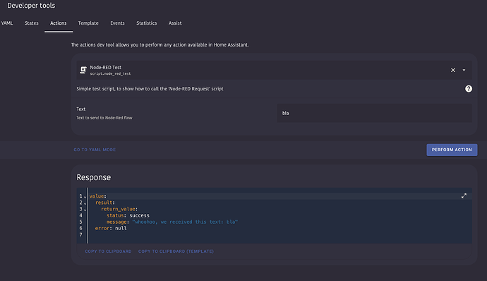

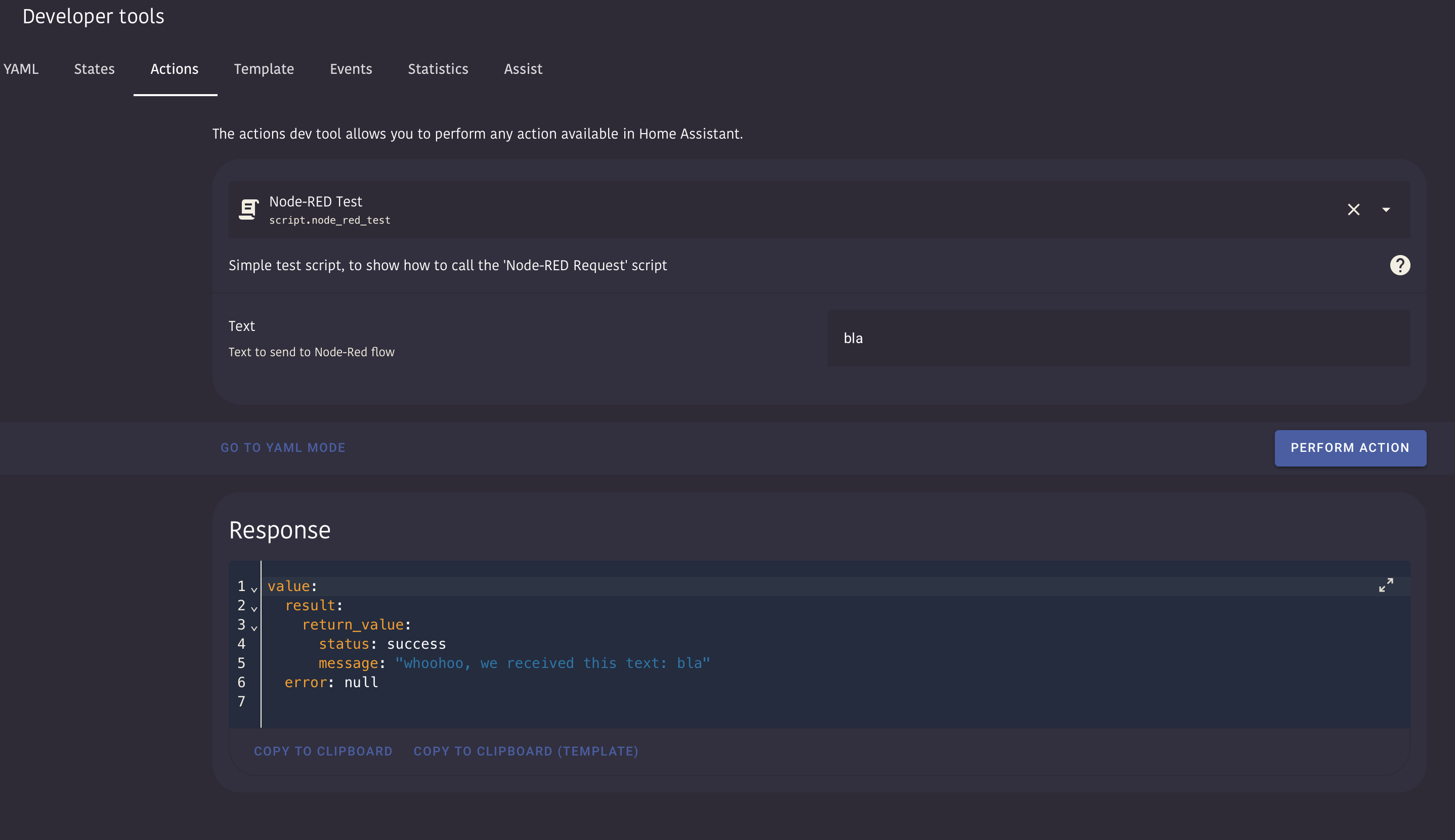

Which in the end looks simply like that when called from the developers tools:
