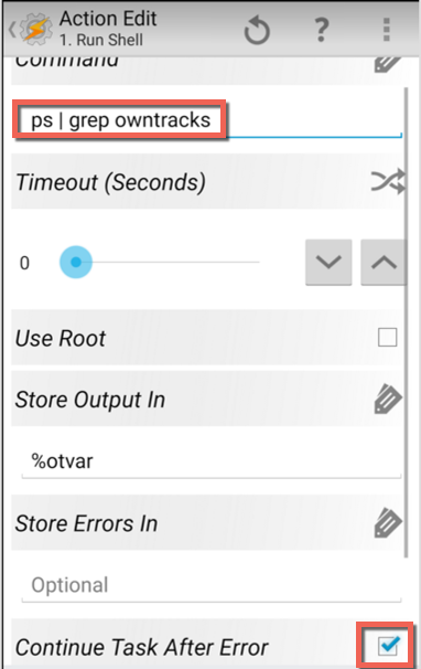

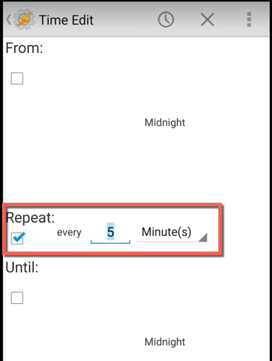

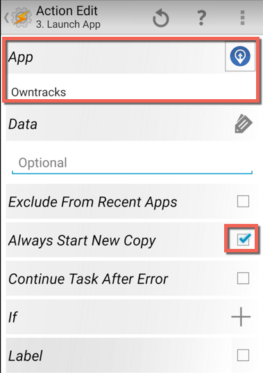

Using Tasker to monitor and restart OwnTracks when it crashes
I’ve found that OwnTracks will periodically crash so I’ve used Tasker to monitor and restart when this happens
Profile screen
Enter an interval to check for the OwnTracks process
Task screen
Task - Step 1
Task - Step 2
Task - Step 3
Task - Step 4 - (Optional but used to track when Tasker restarts OwnTracks)
Task - Step 5
Add the End If
Be sure to save you changes by backing out to Exit and Selecting “Save First”
I’ve added screenshots for the Tasker setup
