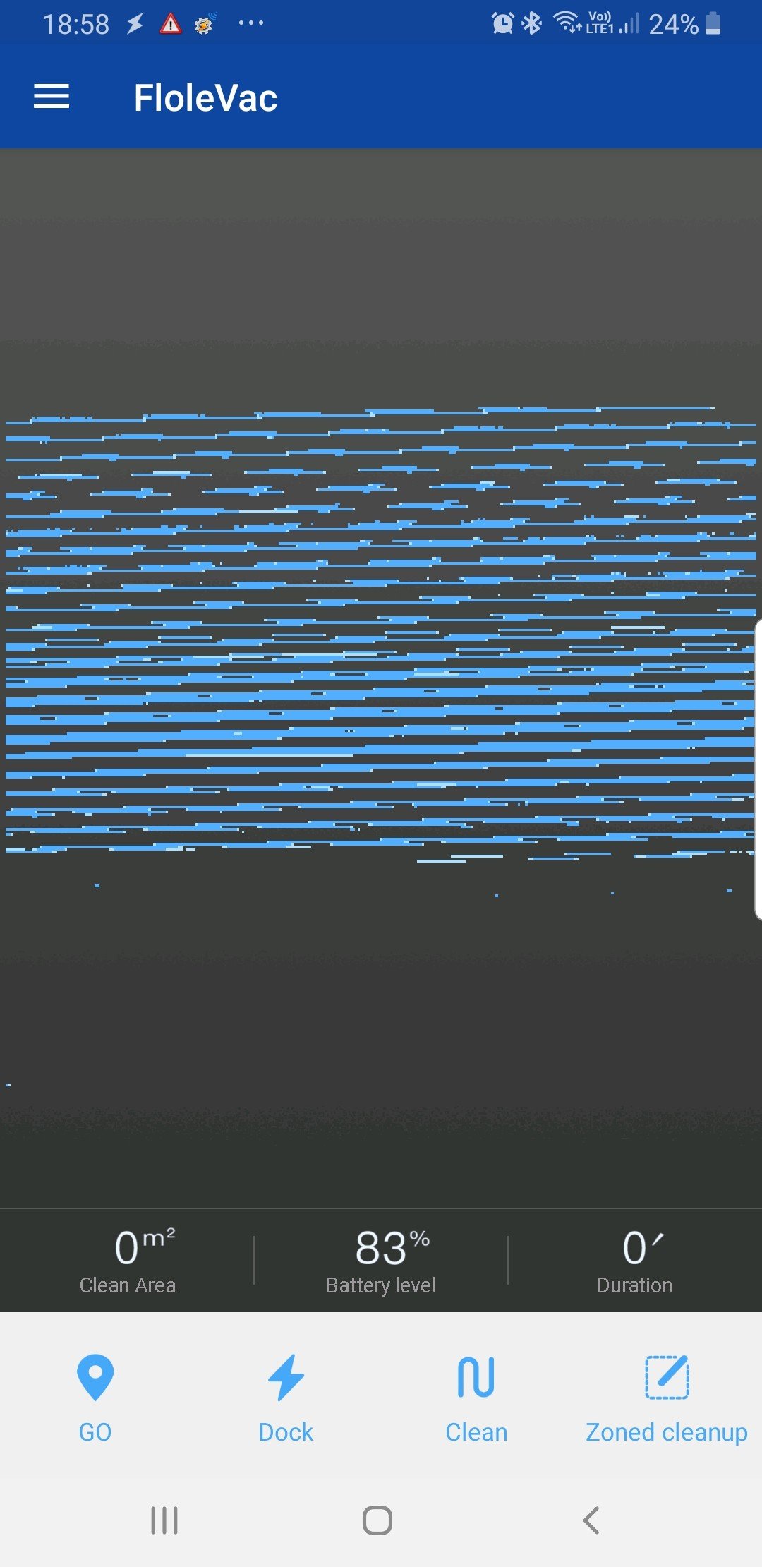

I have got the same Problem (and the same setup). I used to be able to use FloleVac, but I remember when they changed the Server settings (I cant Select Europe anymore but habe to Select Germany) it stopped working for me.
Too bad, I really wanted to use FloleVac. Letâs hope the developer finds a solution.
Similar issues - zoned cleanup service call works from home assistant, zone correctly drawn in the Xiaomi app, vacuum begins cleaning, then immediately says âfinished zoned cleanup, returning to base, some unreached zones are not cleanâ. Canât figure out why.
EDIT: Interesting - I just tested a zoned cleanup from the Xiaomi app and it produces the same result! Now I have no idea where to go.
EDIT: Fixed - to solve this I just had to press âStart Cleanâ once (the full-auto clean) in the Xiaomi app. It started cleaning, I stopped it, and since then all the zoned cleanups are working again.

Just got me an S6 today but FloleVac does not seems to work with this device.
Any idea how to get the cordinates for S6?
the old-fashioned way, screenshot your xiaomi-app screen with your vacuum sitting at the base, use home assistant to send it to specific coordinates, screenshot again. Then create a coordinate grid on top of your screencaps using your known spots (I used photoshop for this) and then read off all the other coordinates from your grid.
Ok thank you, yes I already find some corner corodinates and will try to make the grid. I have photoshop but low knowledge with it. Is it possible to make the grid automatic in photoshop?
You could create a pattern, create a new layer, use that pattern on it and then move the new layer with the pattern to wherever you need it. You can also scale it so it is exactly as big as you need it.
Maybe this helps for creating a grid pattern.
Interesting, thank you very much.
