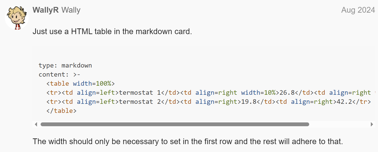

Put it in a table instead and use the width of the cells to control the fields
Thank you for the help! It got me to the answer in a way you may not expect…
Funny story (frustrating) … all four AI systems failed to get an HTML table to work in the YAML after an hour of trying. I’ve not done HTML coding in like 10+ years so assumed it would work as HTML is pretty easy. This morning after your message I search and found…
… then noticed that your HTML was different than the code all the AIs used…
        <tr>
          <th style="text-align:left; width:25ch">Name</th>
          <th style="text-align:center">Last Change</th>
          <th style="text-align:center"></th>
        </tr>
using STYLE did not work, at all, with Markdown
as much as I love HA, its super frustrating how everything in HA is ‘different’. In this case, STYLE has been used for decades but yet HA cant use it… arg. Why not just have a normal / universal HTML card separate from a Markdown (which can only do basic stuff, per its design intended for). Clearly HTML is more well known, more flexible, and can be done without expertise since ther e are 1000 free online HTML generators and AI can do it flawlessly.
… sorry, I’ve spend 2 hours on this now, if normal HTML worked it would have been 3 minutes.
If the HTML in the card is not controlled, then it could render the entire dashboard inoperative and some HTML tags and CSS style settings would have same effect.
I get that. Wrapping the HTML inside Markdown makes things more complicated, especially for noobies since it seems that Markdown doesnt support all common HTML methods.
thanks for the help, its working as I’d like now…
The HA devs have just taken the marked.js and implemented that in a card, so they do not really control the markdown features that much.
