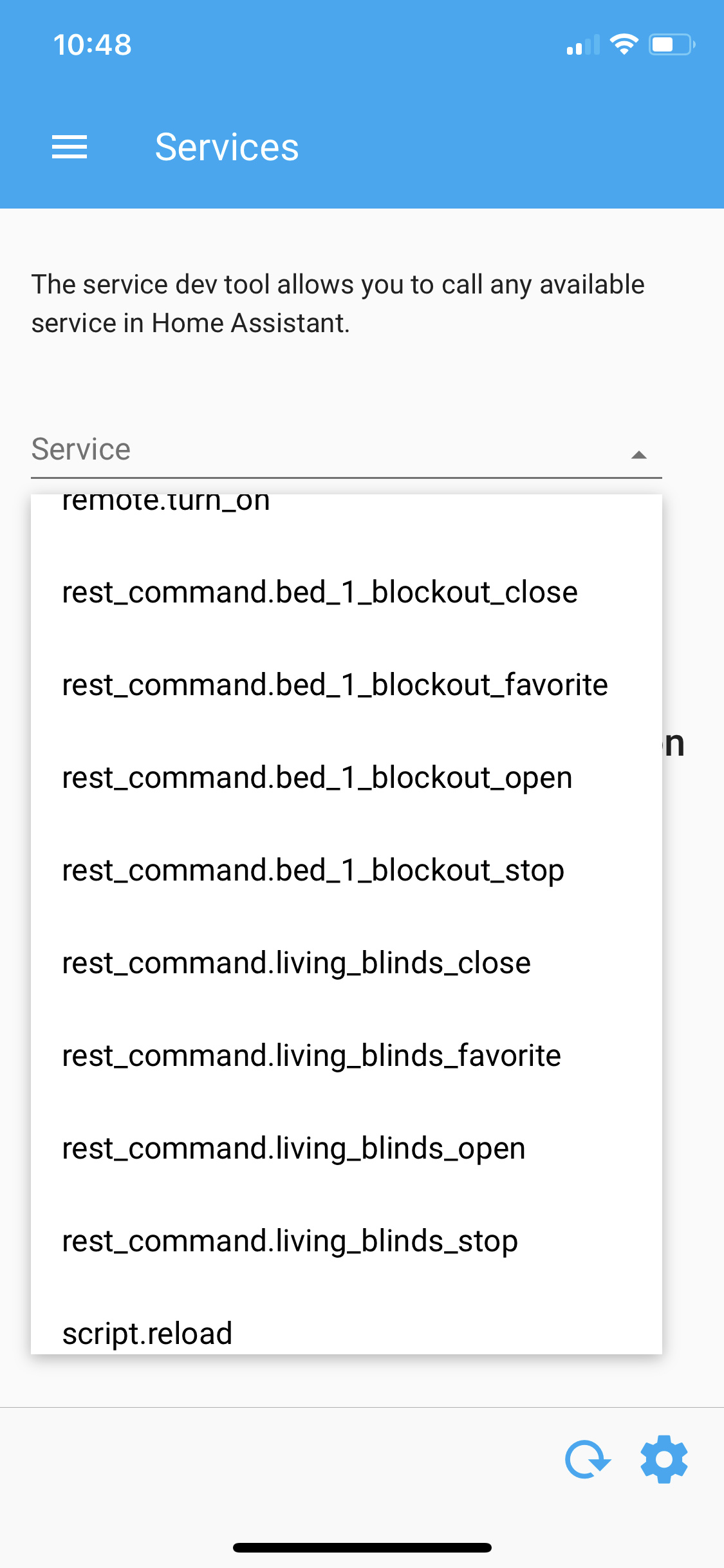

I have some motorised blinds in my house which use an app that I have access to the http get requests. I am trying to get this to work in HADashboard but am having trouble getting it to do exactly what I want.
At the moment I’ve got it working on HASS using the cover template component and having it call a service which I have set up using the Rest Command and it works great. I’ve attached a screenshot of the services which when called work perfect.

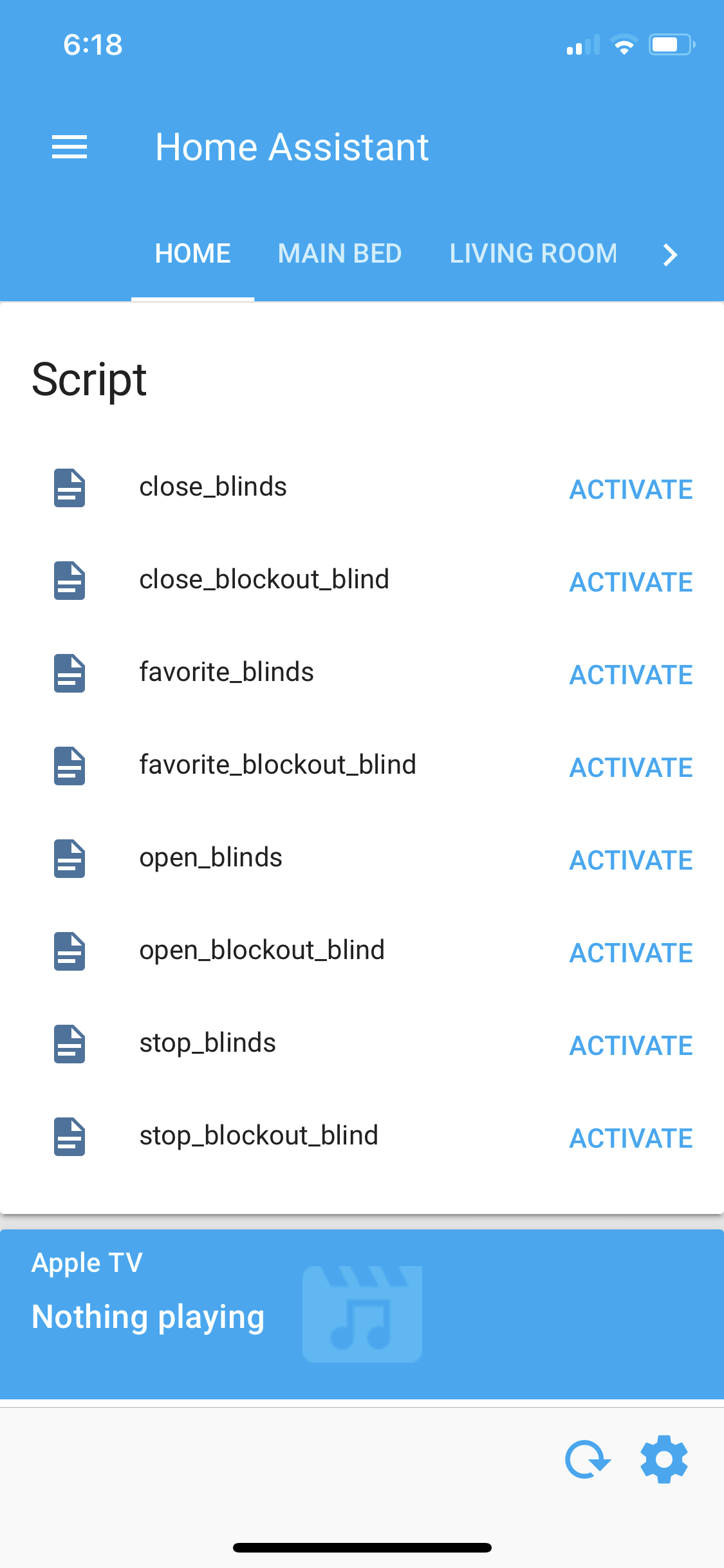

Just a heads up for everyone that I finally got it working. My issue was at the bottom of the configuration.yaml file was a line to look for scripts in the scripts.yaml file. As soon as I put my script in there which called the service in the image above it all appeared as follows and with only the activate button
I then called it out using the script widget in HADashboard which looks a little something like this
So happy with the outcome.
